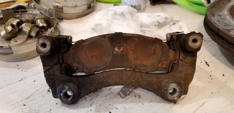

Actually I meant the caliper mounting bracket, which holds the pads themselves at each end. The pads had to be pried out they were pretty much frozen in place. Yesterday it was the passenger side, which I got back together. The rotor picture attached is of yesterdays passenger side effort.
This morning I've got the drivers side apart now, the two pics of the pads and caliper brackets are of this side. Not quite as bad as the passenger side. Both sides of this roter are shiny and smooth. I'm going to wire wheel the mounting brackets and file the slots that the pads sit in a bit, and see if it goes together easier. Then I need to take the passenger side back apart and do the same thing.
What do you think? Wire wheel and a small file ok to use?
Calipers seem ok. Rusty on the outside, but piston area seems ok.
--Bob

Yes, the corrosion is behind those SS hardware pieces, and you can wire brush them any way you need to. Just avoid removing any real metal from the areas the pads contact. A file can be used carefully to remove the build up etc.
If the piston area(the seals) are still fine with no corrosion building up at the seal seems, those can be okay too. Those caliper brackets are very tough parts, yours just need some extra care. Be sure to clean the sliding bolts and holes well, plus use the right grease for their boots. The boots and hardware should be available as a kit from parts stores, if needed. Normally doing brakes on these is as simple as removing the two large bracket bolts, not the small caliper bolts, and swapping pads. Use red loctite(one drop) on those large bolts, those are known to become loose if not made very tight(lugnut tight). Regards,
I’ve had issues where the pad holding notches were nice and clean, and the pads still wouldn’t fit. Checking the new pads VS the old the ears on the pads were smaller on the ones that came out. I had to dress them with a file to make them fit right.
Looking at your pics the abutment clips (the stamped things the pads ride on) look kinda mangled. I’d replace those after cleaning the rust that’s under them.
Red loctite is considered "permanent". That's not say the bolts can't be loosened in the future, but you will probably need to heat them up a little before removing them. Ford loves red loctite and uses it on many important bolts (caliper bracket mounting bolts, body mounts bolts, hub assembly bolts and suspension parts ect). I recommend red loctite on the mounting bracket bolts, but blue on the caliper pin bolts. Without looking up the torque specs, I guess 80-100 ft lbs for the mounting bracket bolts and around 30-35 ft lbs for the caliper pins.
Oh yes, Ford loves red loctite for lots of permanent bolts. Look at any of the rear driveshaft bolts you get out of a pinion flange, they are covered in the red substance, which is why they can be hell to remove. I have a few times got more than a drop of red on a caliper bracket bolt, and cleaned it off with brake cleaner to do it again.

It’s the caliper bracket that’s the issue, not the caliper.
