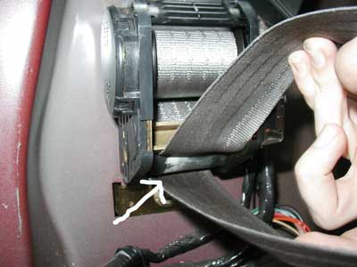

A couple of months ago my front passenger seatbelt started squeeking, and recently it has become difficult for some of my passangers to pull and doesn't wind back up on it's own. So I decided to pull off the interior panel (not an easy job on a 2door) and opened the seatbelt housing to hunt for the problem and now am stuck on how to fix it. In the seatbelt, there is the main roll that the seatbelt rolls onto, and then there is another roller with a rubber sleeve that the belt goes around. The problem is the sleeve slid to the end of the roller and is rubbing up against the side of the housing. I tried moving the sleeve back to center, but after a few test pulls of the belt, it moved back and got stuck again.
So... my question is, does anyone have any suggestions about how to hold the sleeve in place?
I'll try to get a picture up as soon as I can if my explination isn't any good
