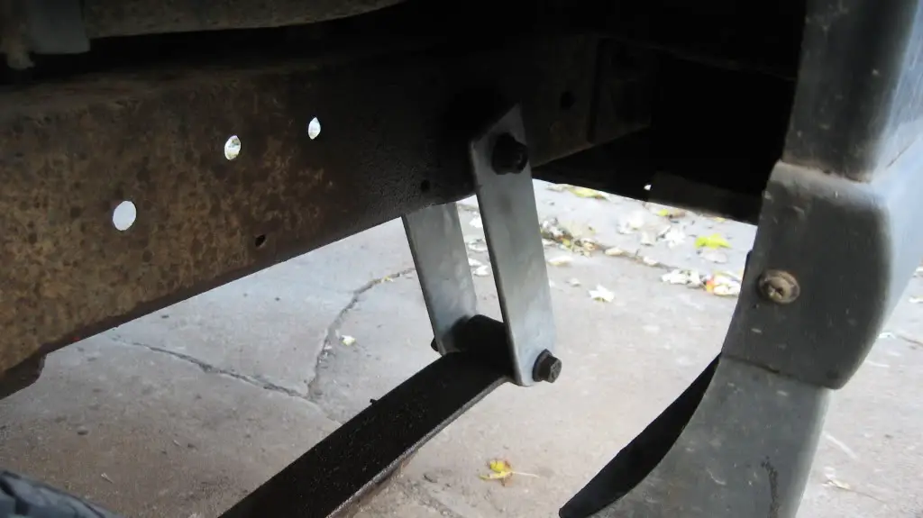

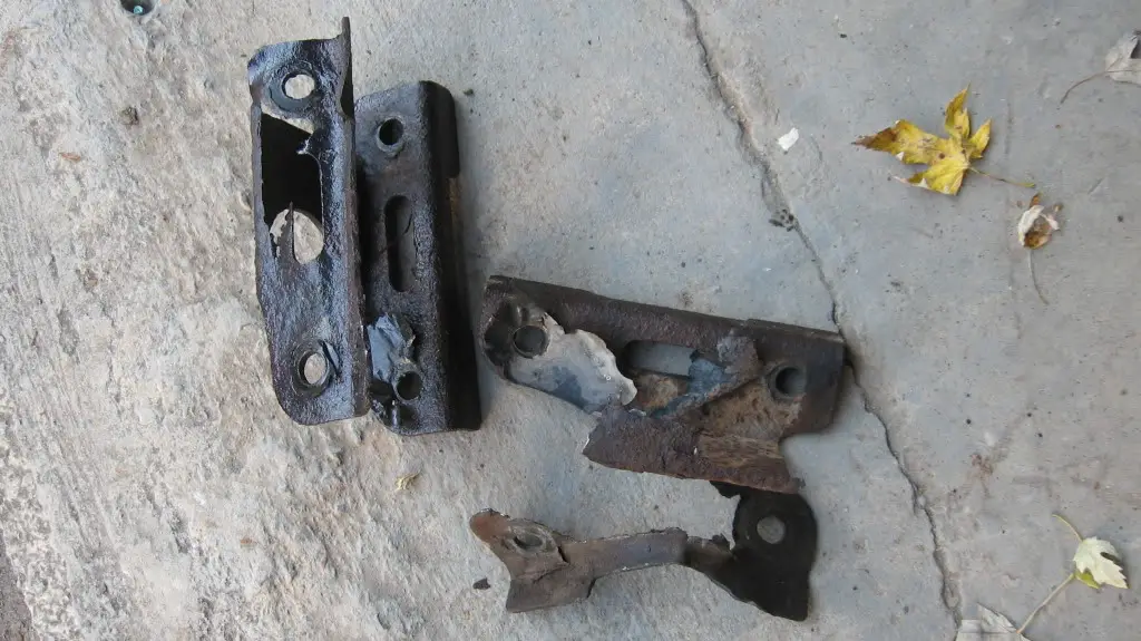

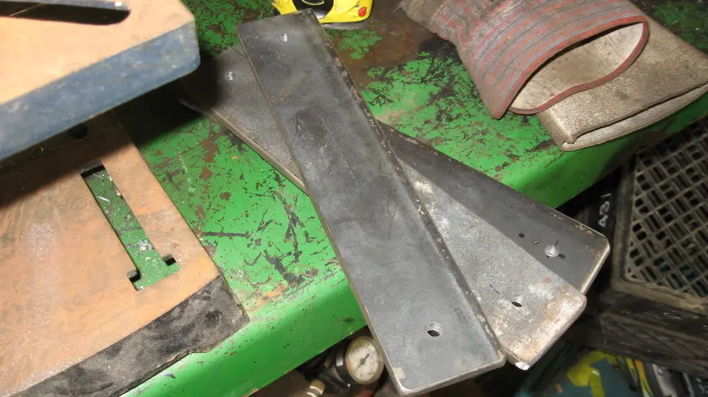

well i made my shackles yesturday. today i was driving to get paint for them and the driverside shackle finally broke, so i came home and started the swap. I made the shackles out of 1/4 flatbar, 2.5'' wide, 9'' hole to hole. The bolt on the leaf spring came right out, the frame bolt..not so much, 3 hours of thrust (canadian pb) and hammering and one broken pry bar later i got it out. i ran out of day light so ill do the passenger side tomorrow and post pics of it all done.

shackles laid out
cut and pilot holes drilled

Thanks for the welcome. got both shackles on now, passenger side upper bolt also gave me a hard time but i hit it with the air gun and a pry bar this time. I got 2'' in the rear and i cranked the torsion bars 1.5'' aswell, i was really suprised how easy the bolts turned and how little it took to get inchs of lift out of it.
old shackles, whats left of them
new ones..yes i reused the bolts, they looked fine.
2'' rear lift, 1.5'' front and yes thats my lil red wagon in the garage!

You might consider adding some sort of lateral support to the shackles though, just something running between each side of each shackle...

in the pic where thier laid out theres a piece of 2x3 1/4wall i was gonna cut a couple of chunks out for supports but i noticed alot of guys dont have supports on thiers. when i rip the rear apart in a few weeks ill add supports and paint the shackles black. :)
From what I know, over about an inch over stock you might want the bracing to assist with vague steering and to help limit the hit on the bushings as they move. You'll have a little more tight ride with the bracing than without. But, not totally necessary if you're looking for the most possible flex.
ill most likely brace them, just seems safer. i wanted to get them on the truck, then tack the bracing in, pull them off and finish weld them just to make sure everything lined up ok. did you build your own shackles mr. dirt? lol
