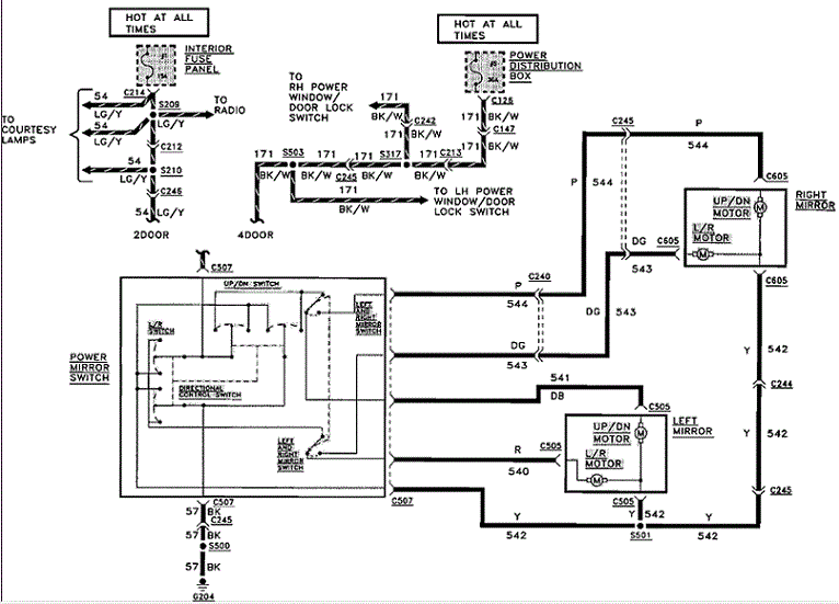

ok i pulled a stupid
i cut the power mirror switch outta my 93 parts truck to replace the one the previous owner of my 91 "lost" he also "lost" the connector, what i need is a pic of the connector still wired in a 91, can anyone help? ive checked all the pics i could find here and on the internet, alot show the panel and the window switch but i cant find a close up of the mirror swicth, thanx in advance
