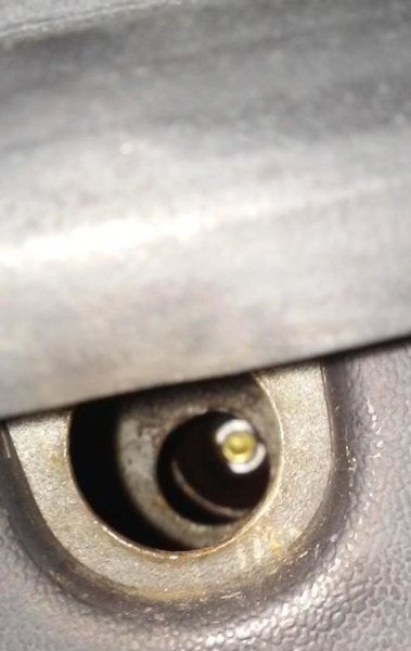

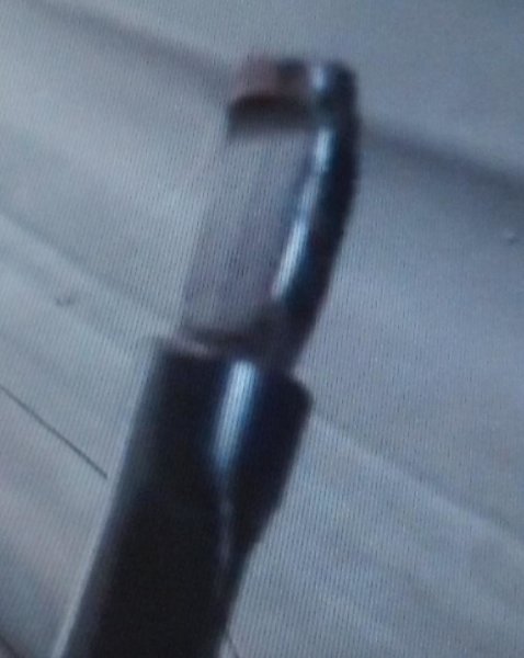

Anyway gang...feel stupid here...so I went to remove/lower spare tire to check out Vent canister/ hoses etc and confused about release connector....so I just see/have a gold rounded 1/4" tip inside release hole.... not sure if that's tip that got separated and stuck in there from tool...being this is supposed to have a female opening for release tool..not tip....... see pics...and please elaborate away..... GOLD ROUNDED STUB INSIDE HOLE... FOLLOWED BY RELEASE TOOL END PICS:

The end of the black rod is correct, just like my 97', (just re-installed my spare yesterday). The rod is supposed to fit into a rectangular slot to drive the cable mechanism, I dont know what that is down inside there, maybe the cable mechanism was replaced?
I guess what I perceived to be the "walls/tunnel" are the actual turning mechanism.....I just rechecked with flashlight and going on that assumption....I do NOT have that rod/tip ....that was the one piece the previous owner didn't have inside vehicle...I'll access one tomorrow.......I just posted pic I found online to support my theory why I assumed the very end would be female for this........ the "tunnel" is about an entire inch long so I was thrown by that as well... Feeling somewhat lame now... :)
I hate those spare tire winches
You have the correct piece to stick in there and turn
Lefty loosey = drop the tire
