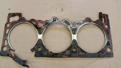

I ran tty head bolts on my heads with felpro SD gaskets on my 11:1 supercharged 12psi and a 50 shot nitrous. ..it did blow the red felpro to pieces though. .both tty..i wanted the gaskets to blow before the stock bottom end did...
