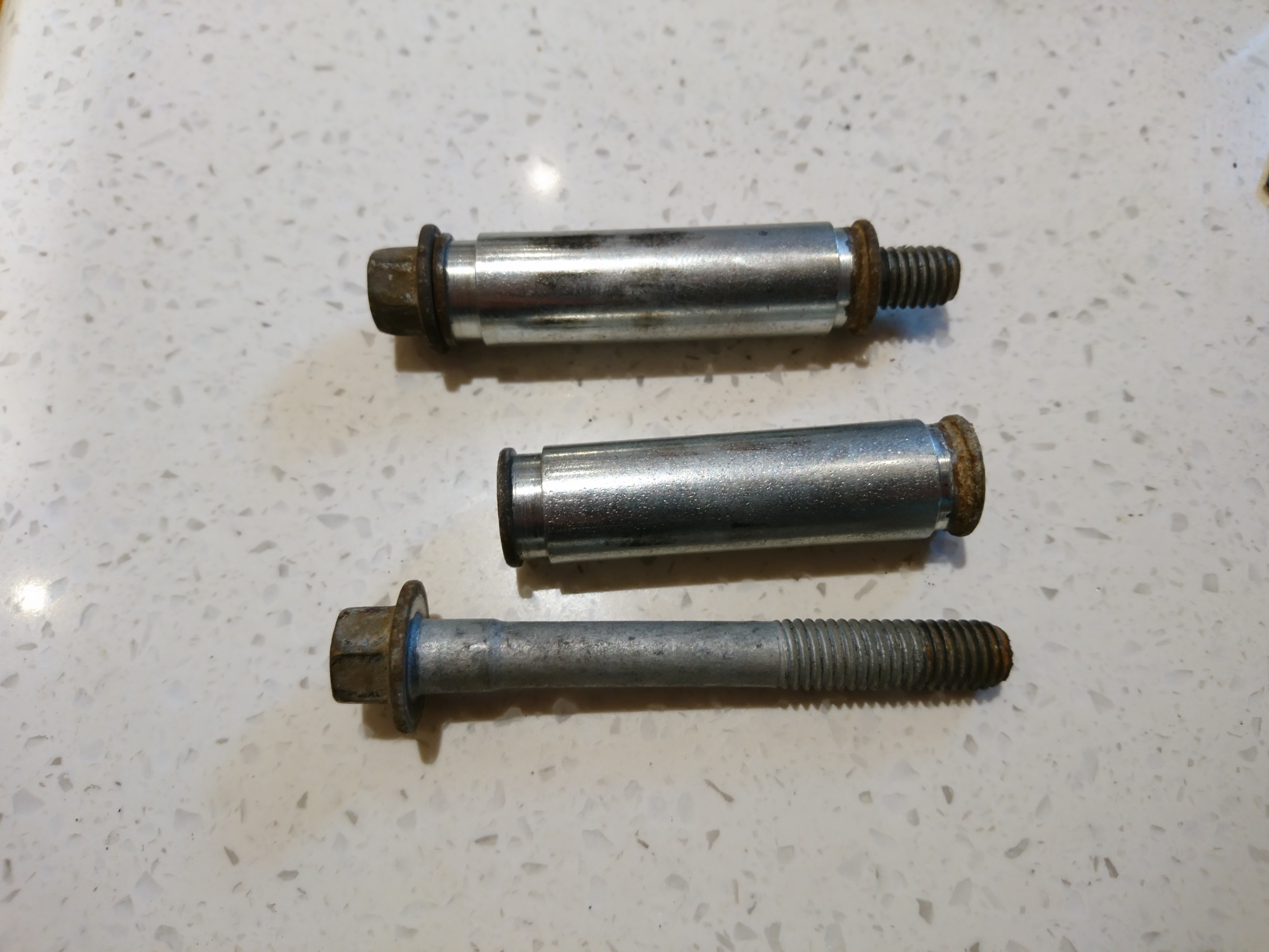

I have silicone grease, I just wasn't sure where all to use it since the rear guide pins don't seem as obvious as the fronts. Anyway, I've attached a picture of the bolt and slide. I wasn't sure whether or not it needed any grease where the slide goes over the bolt.

Clean the bolts well and apply a light coat of brake caliper lubricant on ALL metal contact points. Although these are front caliper slide pin pics, this is what happens when ordinary chassis grease is used on caliper pins when close to the heat of brakes. Had a friend do a "pad slap" on my grinding front brakes at work. Nice favor, but didn't have or use brake lube. Pics shown are front pins after less than 10,000 miles.

The front and rear calipers on these SUVs are very, very different animals. Front is the more modern (and better) "Colette" design, where a short bolt attaches the guide pin to the housing ear, and the length of the guide pins slide directly into the bracket bores during assembly and in-use. For this, moderate lubrication of the pin/bore interface is needed, and a little excess will simply squish out into the dust boots.
But the rears are old-school RPS design (Reverse Pin Slide). As the OP said, there is a long metal sleeve involved, that the other design does not have. This sleeve is completely contained within the long, convoluted rubber boot, both of which are squeezed thru the housing ear. The main sliding lubrication in this case is needed between the metal sleeve and the rubber boot, NOT between the pin-bolt and the sleeve. The pin-bolt simply goes thru the sleeve, and threads into the bracket, clamping the sleeve securely to the bracket. The sliding occurs between the housing ears and the bushing/sleeve. Any lubrication between the pin-bolt and the sleeve will simply be along for the ride. A very thin film-coat would not hurt anything, but is not necessary for caliper function.
Thanks for the detailed explanation! I went ahead and lubed just the outer sleeve since I realized that was probably the only part that needed it. My brakes feel so much better now after changing out the rotors and pads and cleaning/greasing the guide pins (one of the front ones was seized and I replaced it with a new one).
