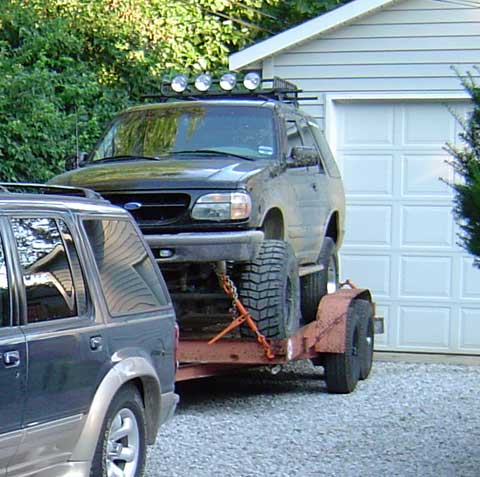

round explorer procomp lights with 100 watt bulb upgrades mounted directly to the rail of my yakima load warrior roof rack. And yes I still fit in my garage with the lights and 35" tires, but I do have an 8' door...;)

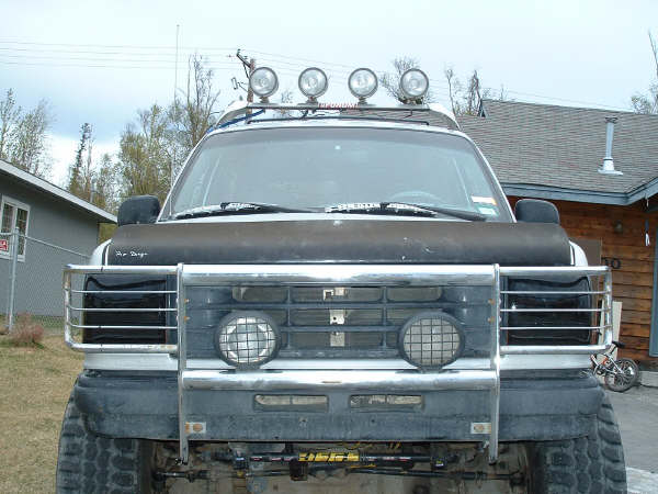

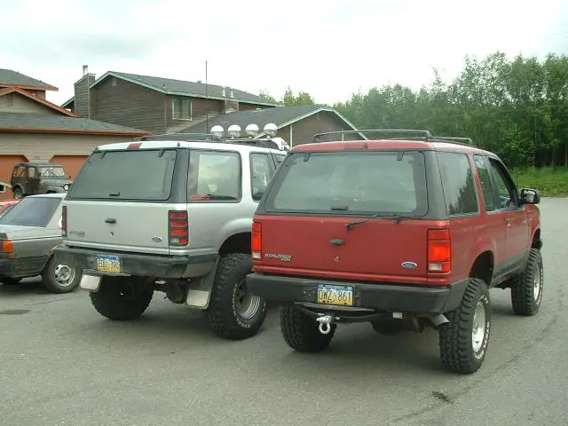

Here's a couple shots of mine mounted on brushguard and Stealth light bar
Originally posted by HokieBert
Hey Splash.. i guess with those lights you can't fit in any garages?
Some I can and some I can't... i only have a 3" B/L, so mine isn't real high. I can get far enough in to work on the engine and change oil though.

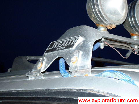

My wiring runs down the door pillar next to the front window and intothe grommet that the wires for the door switches. It then routes under dash to switches and through firewall. It is wrapped with blue flexy wire wrap and looks real clean.
It was this way when I got vehicle so I never bothered with it. I am adding 2 more lights when I change my bumper to an offroad one.
You can kinda see the blue coming off the Stealth light bar on the left and dissappear in this pic
Well it looks ok now that I look at a closer pic I found.
the red wire sticking out from the bottom of the light to the nut, is that your ground for one of the light??
Like I said it was on when I bought it and haven't even messed with them.
