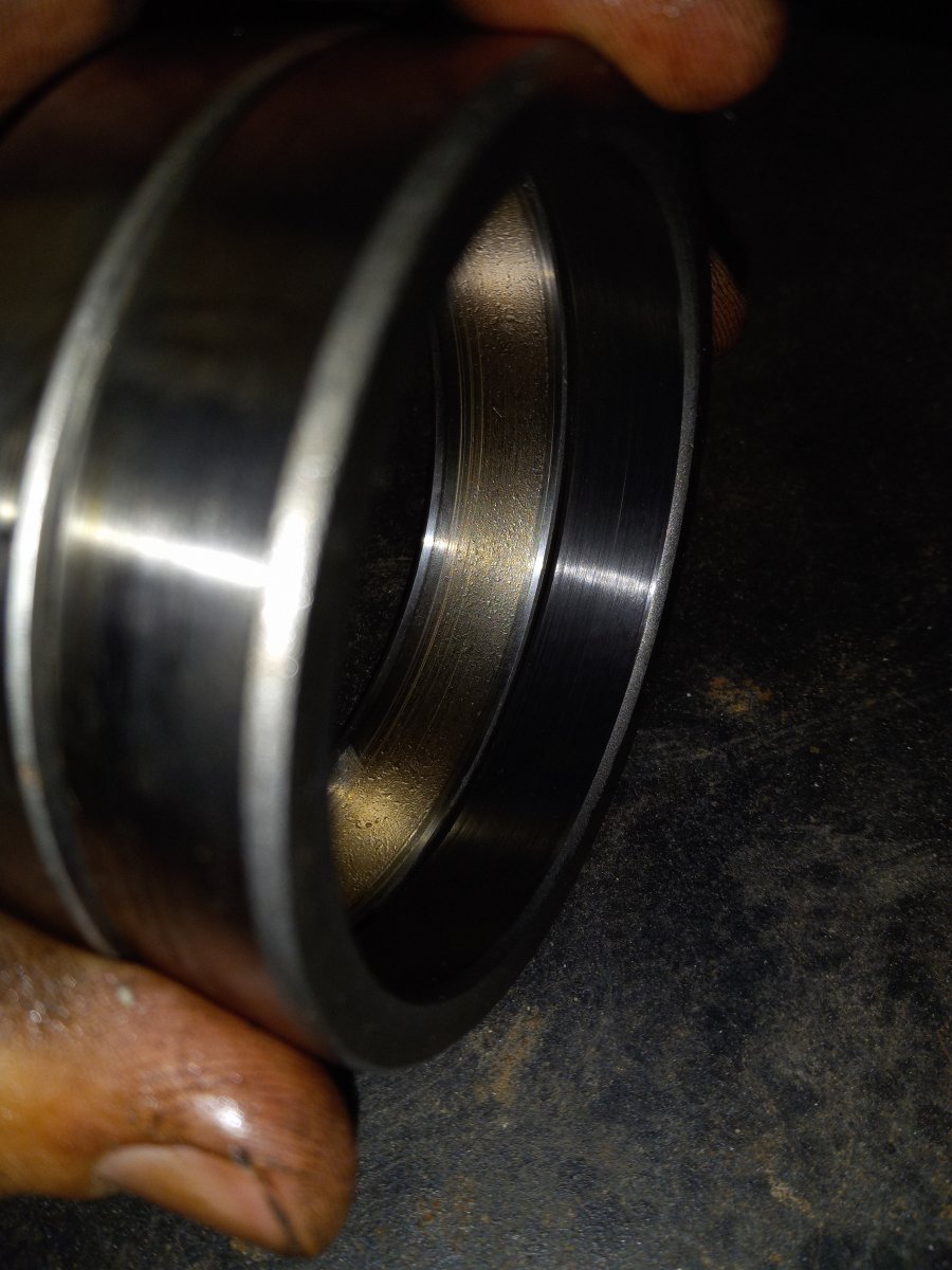

Ok, I'm going to agree with you, but I still can't wrap my head around how all that works. I guess that makes sense being that 410Fortune suggested taking the front drive shaft off to see if the noise was still there. I will be putting on new radius arm bushings, drivers side wheel bearings, ball joint(s) and an alignment. So, I guess we'll see from there. Thank you for your help.
Well, I was able to figure it out. It was the driver's side inner wheel bearing. You can see how the old race is pitted. It's still wild how it was acting like was the passenger side. But thankfully no noise anymore.
I still plan on doing radius arm bushings, ball joints and alignment. Thanks again for all of yalls help.
