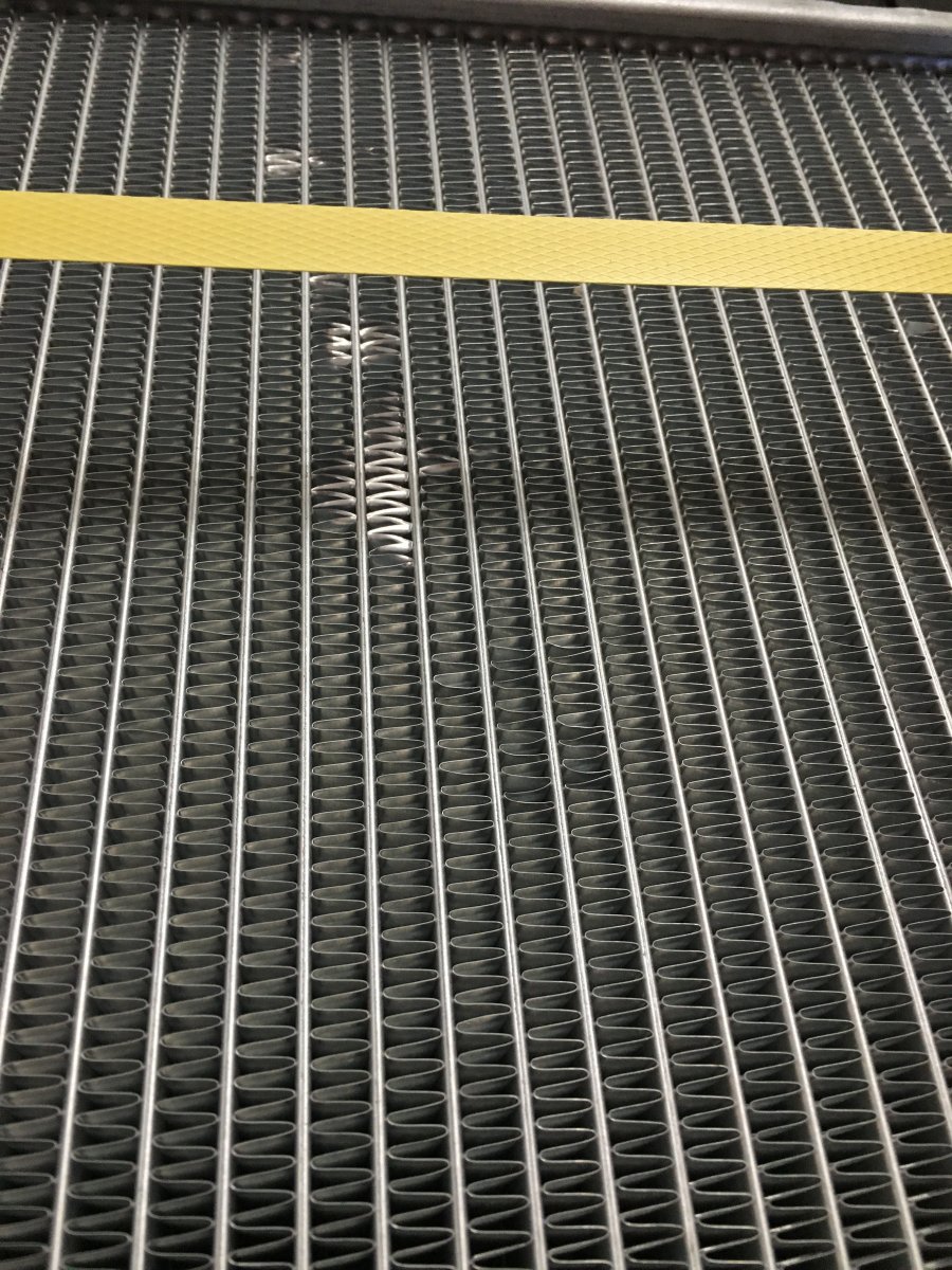

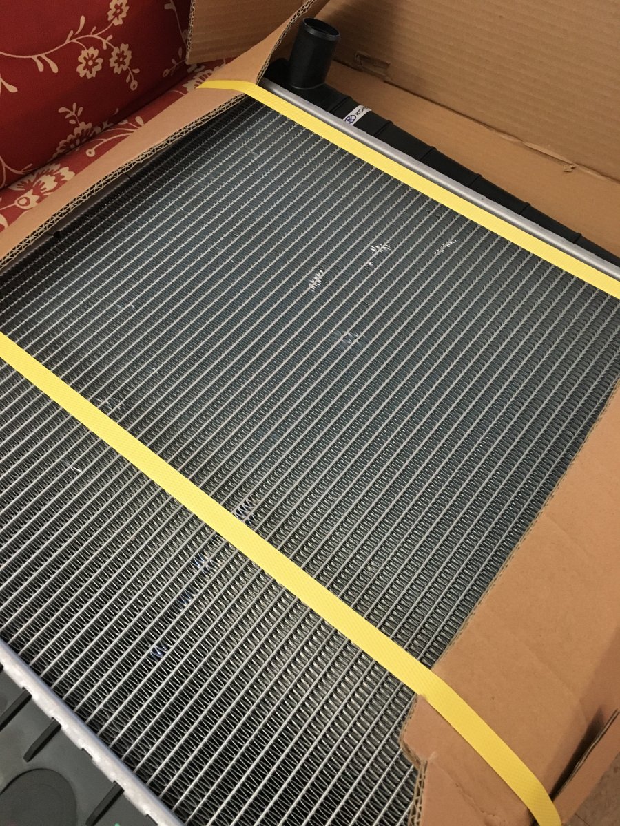

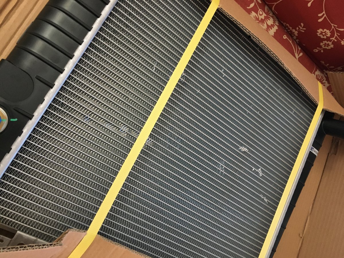

I had purchased a Radiator online and it just arrived. Upon opening it I noticed some of the fins are bent. Will this be an issue or should I return it back to online store? The three photos are the same just differnt angles
That's not too bad actually. You shouldn't have to, but if you cut a hair comb , using 2 or 3 teeth of it you can straighten them out pretty well faster than returning and waiting for another , probably with worse shipping damage. I'd run it

Thank you. I did a few of them with a toothpick and will try the comb method later tonight. Didn't know they were so fragile while using the toothpick.

Totally agree with Turdle…. Run it!
No problems.
