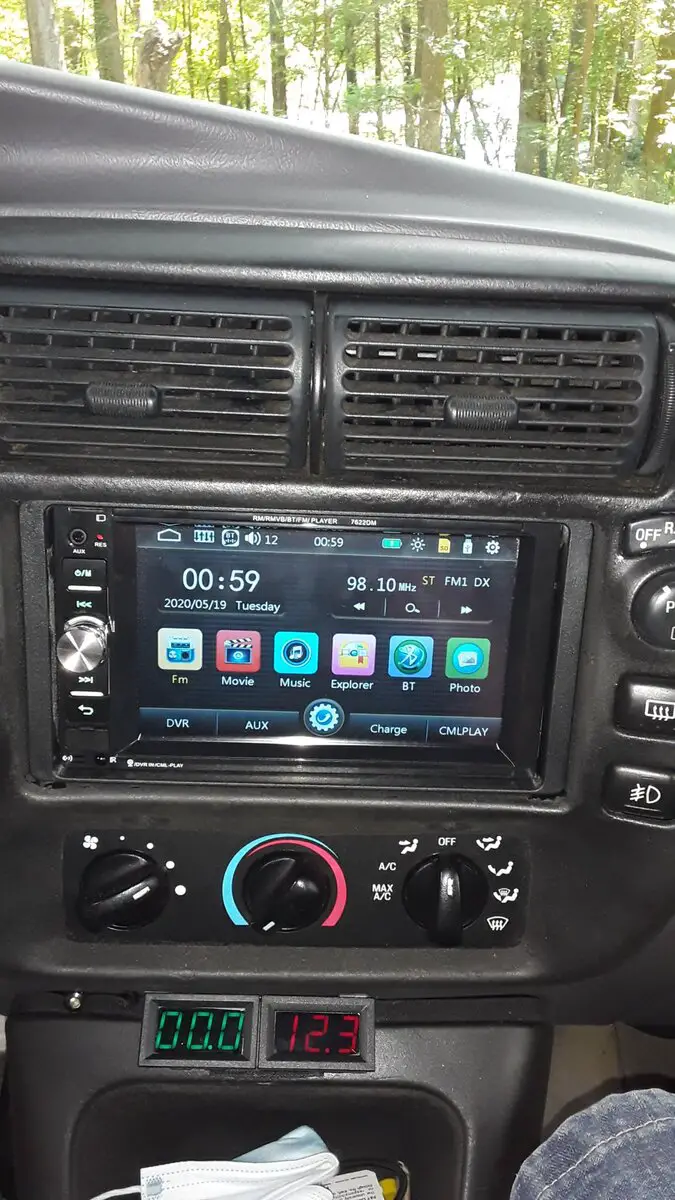

.I just replaced my factory radio
I used factory speakers
This thing sounds great to for a standard replacement
https://www.amazon.com/UNITOPSCI-Car-Multimedia-Player-Receiver,Rear/dp/B07LGTCLKY
I did not use the camera or remotes
