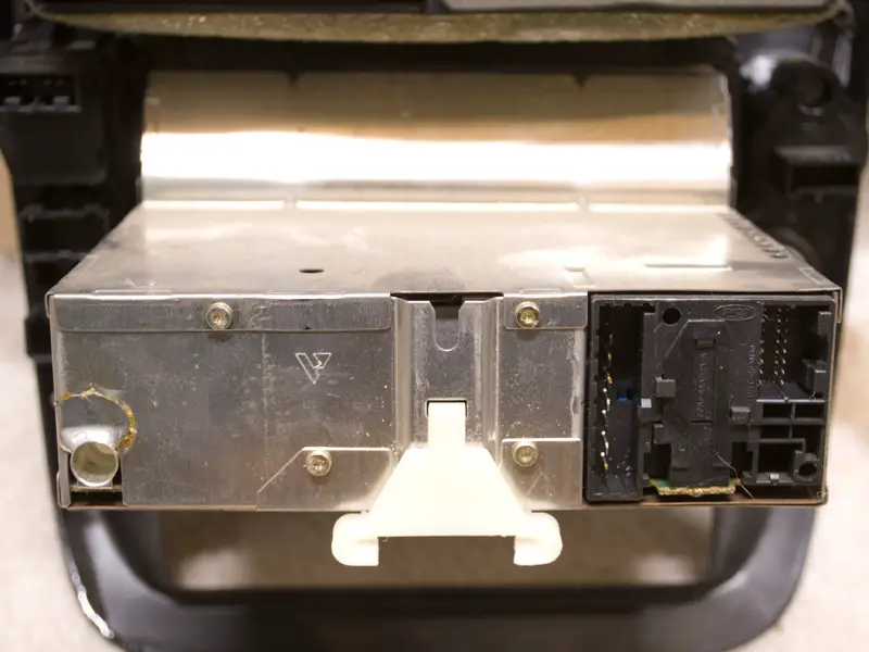

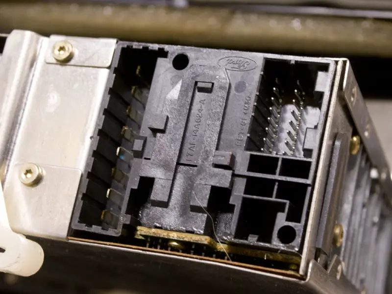

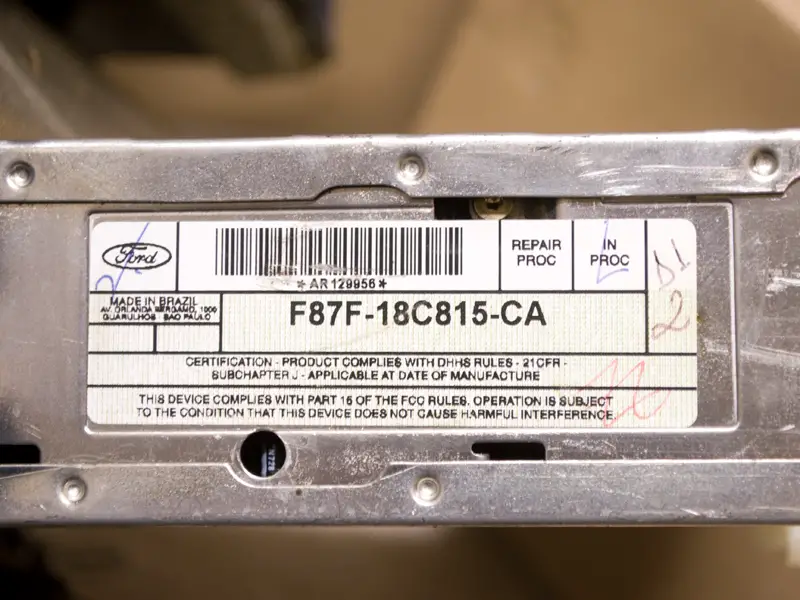

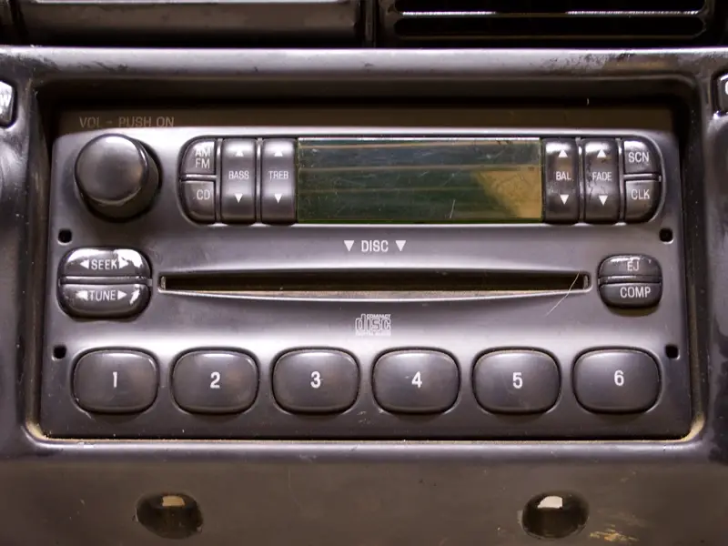

Sorry for the thread hijack but since another member asked for pics, I might as well upload these here for reference. In these pics, the radio is still in the "bezel" but of course the bezel itself is not part of the radio. Again, this particular unit is from a 1998 XLT.

hmm, looks like the connectors that I have spliced in on mine currently would fit yours.
I was able to meet up with Sogsnakebite and we found out that my radio unit is in fact not a 98, but much newer since it has both CD and tape deck. I still have to splice in the new connector that I got from Sogsnakebite to see if it actually works.
