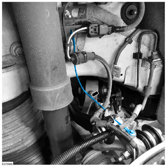

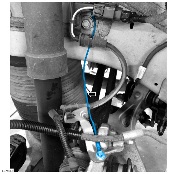

1. Install new ground straps on each side of the vehicle on top of the brake hose bracket bolt on the rear knuckle. Tighten to 133 lb-in (15 Nm). Refer to Workshop Manual (WSM), Section 204-02. (Figures 1-2)
Figure 1

Figure 2

2. Install the other side of the ground straps underneath the rear wheel speed sensor harness bracket mounting stud. Tighten to 62 lb-in (7 Nm). Refer to WSM, Section 206-09. (Figures 1-2)
