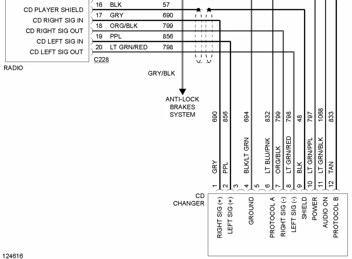

Note that there is also mod potential on the units with the external CD changer, to connect an analog source, whether a phone headphone jack or something else.
I'd expect that it sends a line level signal to the head unit, but this could first be measured for about 1V AC playing a continuous tone. If it's nowhere near that, then this mod might need an opamp in series to preamp, or to attenuate (or a resistor divider instead) to the right signal level.
Anyway, the CD changer has what you'd expect, analog input to the head unit. "CD Right Sig In" as right channel positive, "CD Right Sig Out" as right ground, and the same for the left channel. These inputs could be wired to a stereo jack, RCA plugs, even a bluetooth stereo receiver module (about ?? $4 on ebay) that you produce a 5V power supply for (simple LM7805 regulator would do fine).
My situation is a little different. I have the high series radio, with the amp in the back, but no sub or CD changer, so I don't have the separate input channels for the CD changer (AFAIK), but could just use a DPDT toggle switch, to switch from radio, to a hardwired analog source feeding the amp directly, and depending on the gain of the amp, might need a boost circuit and pot for volume, basically a slightly modified headphone headamp circuit would work... again about a $4 cost to get something basic on ebay if not DIY. I suppose if I wanted to get intrustive to the head unit, I could measure the signal coming from the CD player, cut the power line to it, tap into its signal output and use that as an input once it is determined how the signal strength needs adjusted.
