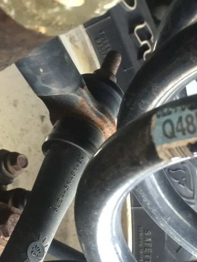

FINALLY dug my stands out since im changing the girlfriends dino fluid today, and decided to back up on them real quick with my X.
Passenger side:
Drivers side:
I swear I looked right at this back when I looked; but what im thinking is the bushing might have been messed up or the bolt, or both, but it was probably still there at least, leaving me to assume it was okay, and it must have finally snapped off somewhere.

I backed up on my ramps again, took the passenger side off with ease (Used my air gun for this, closed end wrench on the top nut), few light pushes after the nut was off and it came out no issues. Put the new one in, secured the nut on the top (Dont know if this was the right way, but thats what I read in another thread. Honestly dont think it matters)
The other side is where I ran in to troubles since the bolt and upper bushing had broken off some time ago. I drove off the ramps, jacked the drivers side up, took the wheel off. I thought cool, I can just pound it out with a hammer. Nope.
Ended up getting the sawzall out after numerous tries with wrenches and hammers, cut it about 1" from the bottom where my saw would reach, and a few light hits with the hammer and it was out. I threaded the new one on again, put my wheel back on, took it off the jacks, and followed the instructions someone posted from Moog:
