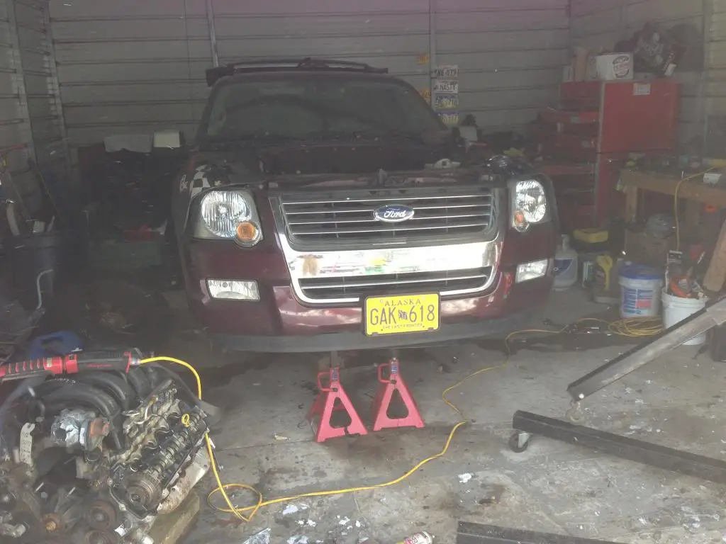

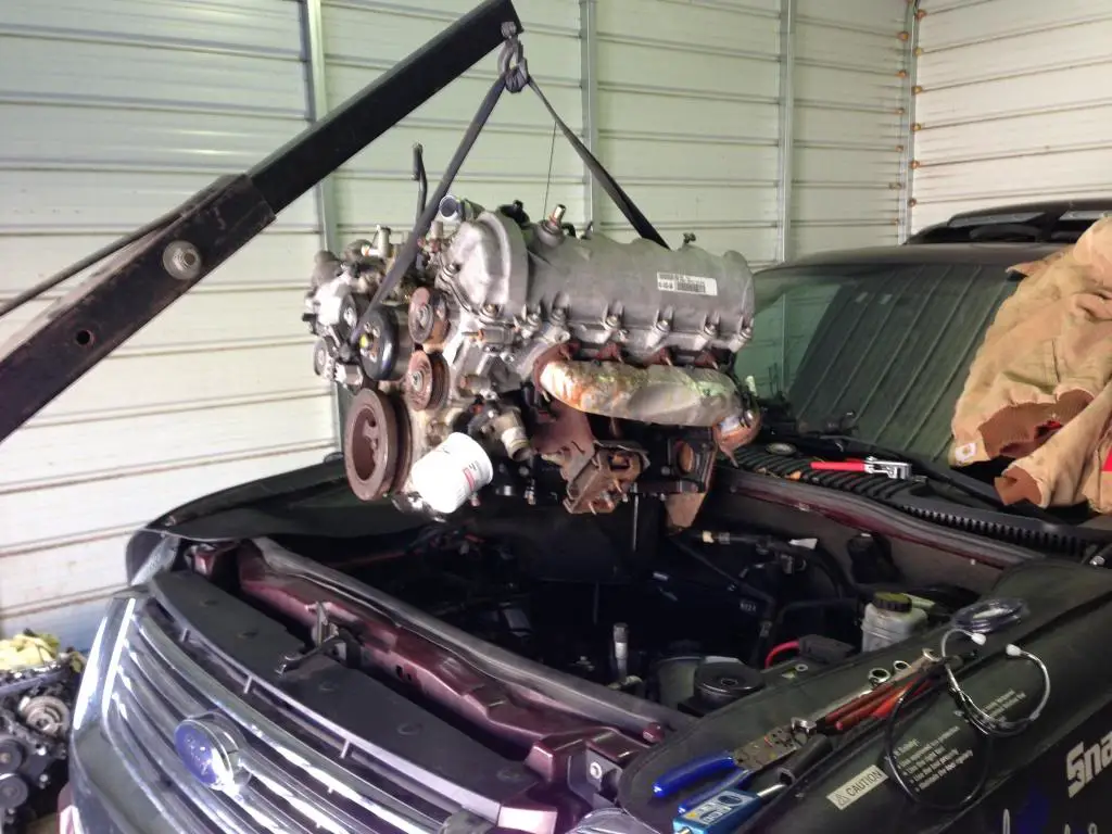

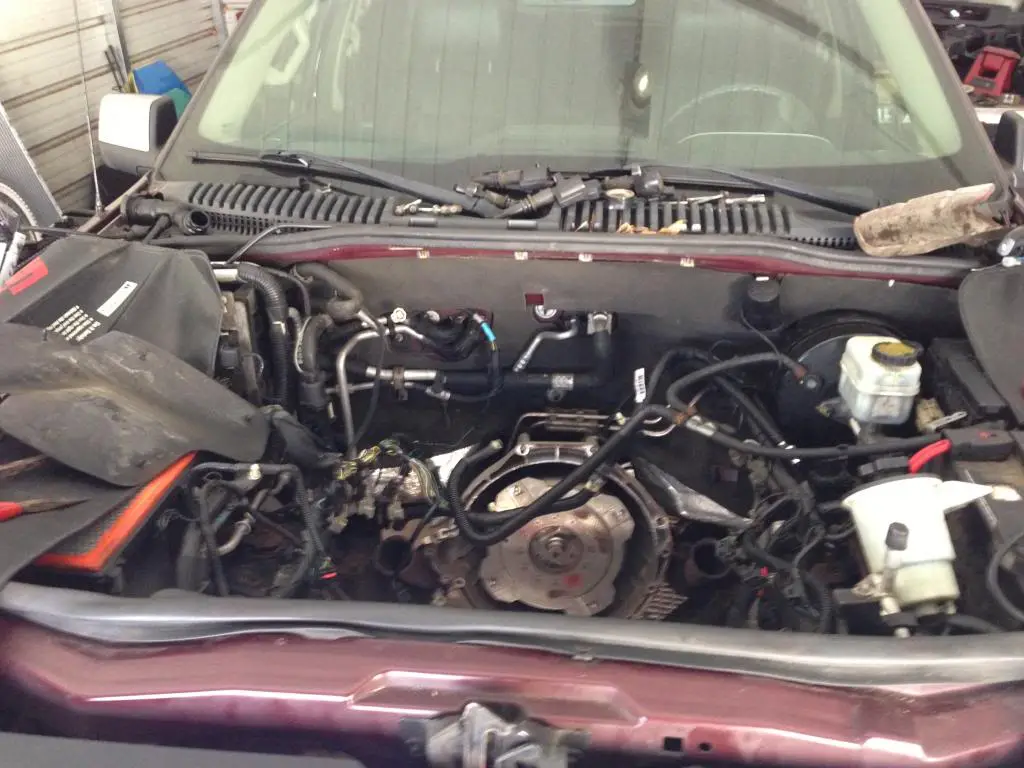

I do plan to do an oil change after about 300 miles on it. I took some pics for you.
This was this morning
Here it is with no motor in it
Old motor

going back in
Have to stop right here to put power steering pump and AC compressor back on
Took 3 hours to stab the motor mount back in. That was a pain in the ass. I bolted the trans to the motor and stopped for the night.
