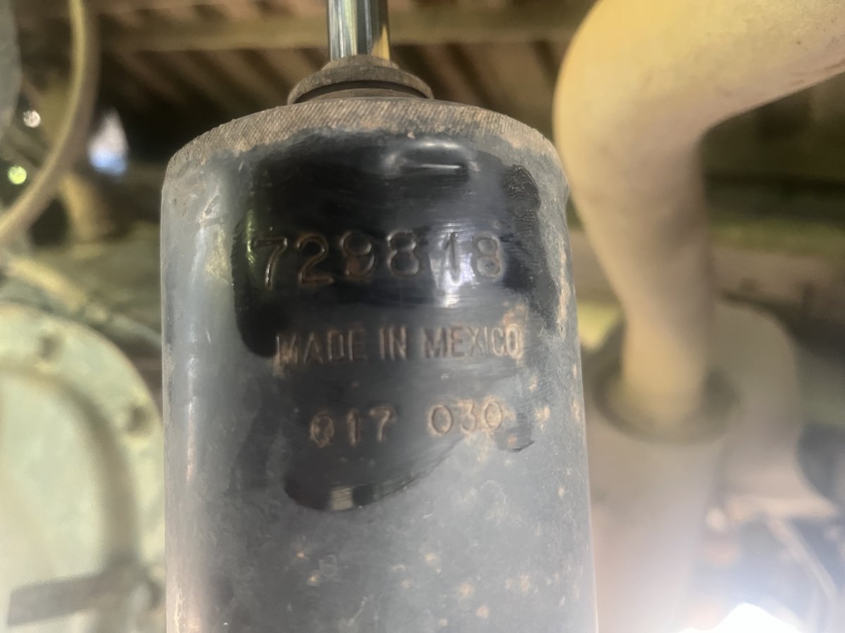

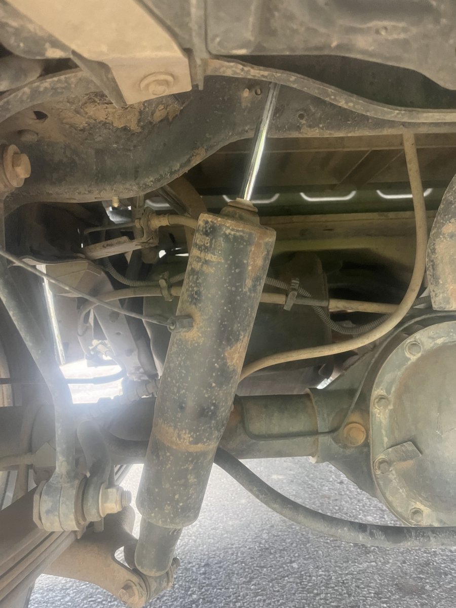

My truck has some air shocks in the rear end but I cannot find them online anywhere
Part number on them is “729818” some pictures are included below if anyone has any information

As far as I know, HiJackers and Monroe are the only air shocks available, but that # doesn't match either. I've had both on my '02 Sport Trac and much prefer the HiJackers. They provide more lift with less air pressure and therefore ride better, and they last longer than the Monroe air shocks.

I really enjoyed the air shocks when they worked but one of them blew a seal somewhere and will not fill up :( I load this rig up for long weekends of “overland” it’s nice to take away some of the stress for the leaf packs on the heavy hits. I’ll take a look into the helper spring Monroe’s as well!

Did you have a load leveling system or only shrader valves?
It was only shrader valves no load leveling. Thinking of saying the hell with it and cabbing in some adjustable fox or nicer bilstiens!
I just stumbled onto my old HiJackers, and that 729818 is stamped on them, so you have HiJackers. My guess is that is the part # for the tube, which could be used on several shocks, because it is not the part # for the complete shock.
Sorry have not logged on in a while but you legend I agree I think this the right shock found them on their site! Appreciate the help!
