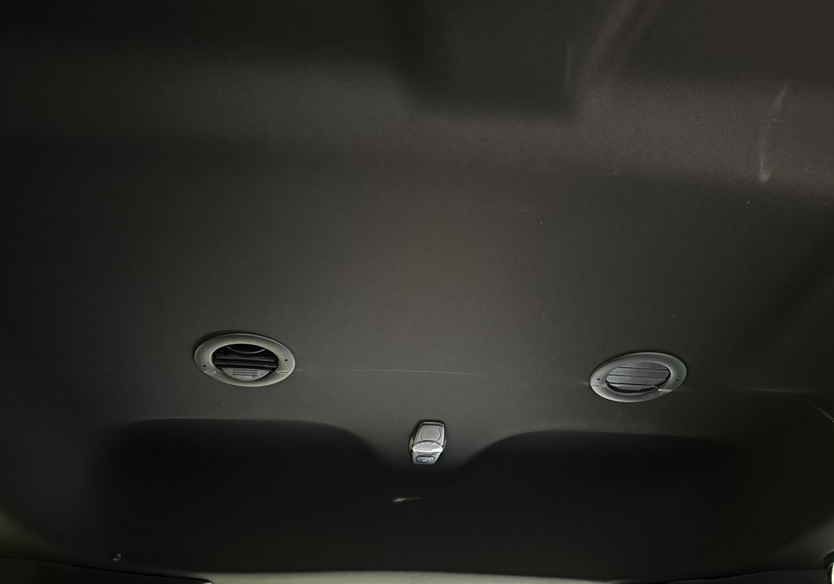

If it does not have the option factory installed there is no a/c to connect the controls to. The vents in the headliner are present in all models as they only produce one headliner for the whole line. Just as there are 3rd row seat belt holes in the D pillar trim but the PIU has no 3rd row or seat belts for such.

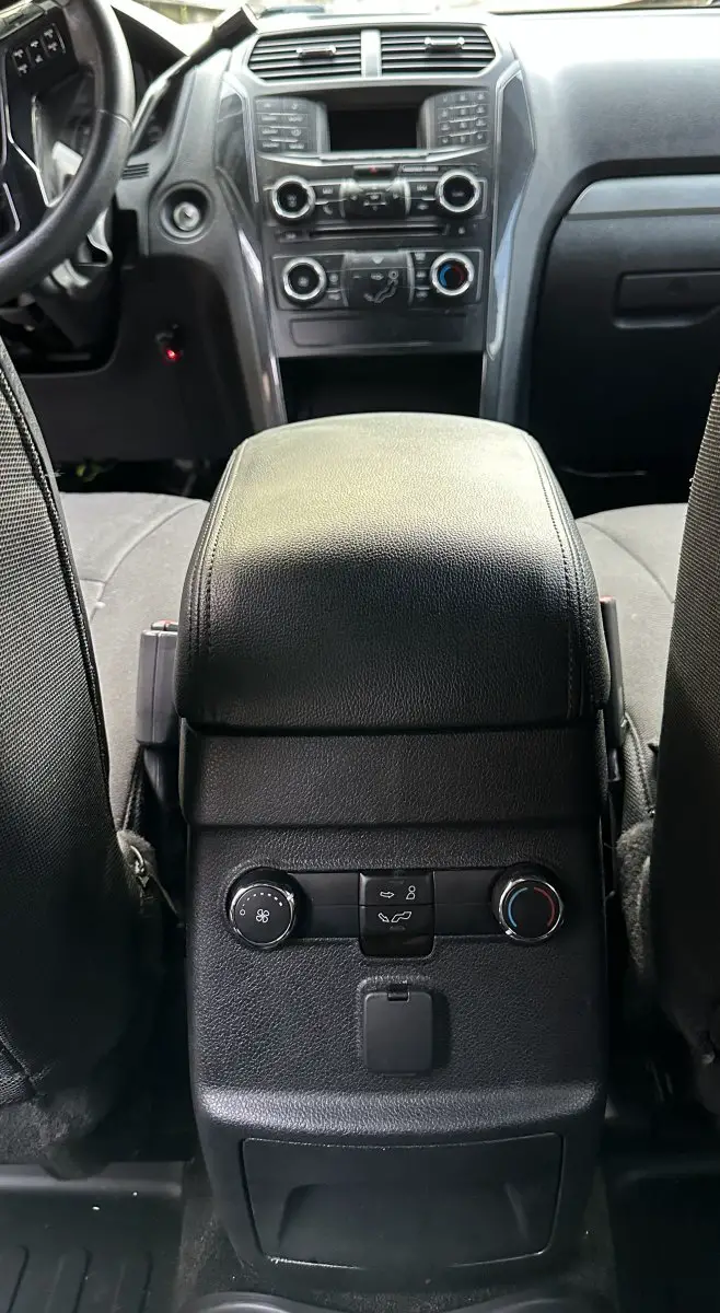

Was the issue of no rear air resolved? I have a 2018 PIU that only has front HVAC controls and no rear controls. When I got this vehicle the civilian center console was added, but he said he didn’t have enough wiring at the time to make the rear connections. He later said he didn’t think he could have made them anyways. Long time friend and I have no reason to doubt him. Suggests?

Does NOT have the duct work. It is a different harness for the wiring!

As others have stated, chances are the ducting is not there. The headliners are all built with the vents but they don't go anwhere. If you pull back the rear left quarter trim you will see for sure if the blower is back there. I am willing to bet it is not. If you want to eliminate the temp controller you can replace it with one of these panels which have the option to replace the space with USB charging ports or just a blank panel.
I have a 2016 PIU that was a K9 unit, yes I have an AC unit in the rear which works perfectly and is controlled from my front end. I have purchased a console from a regular explorer that has the AC control and would like to be able to wire it up to be functional. Has anyone been able to do this?
