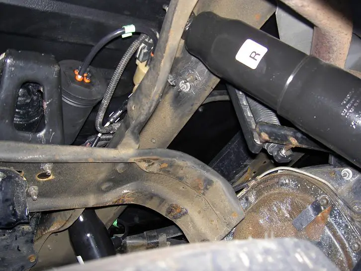

Keep that assembly well clean and lubricated, it costs over $175 new from Ford. Here is a picture of mine after installing some new parts. I adjusted my rear ride height by lengthening the frame mounting holes etc. Regards,

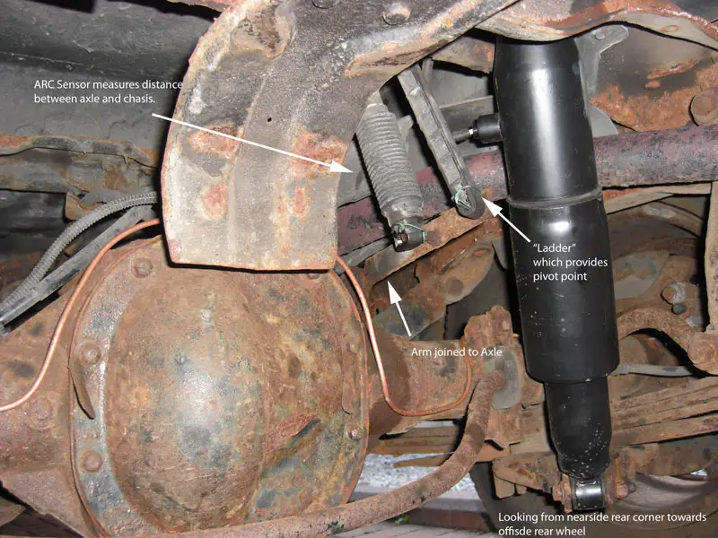

And here's a annotated pic of mine. Note I've had to tie the ends of the sensor and the ladder onto the arm as they had worked loose due to corrosion.
Like my rust!!

Thanks for posting pictures guys.. I've just crawled under mine and both the ladder thing and the sensor weren't attached to the bar..
I popped them back on and secured them with some plastic cable ties and as soon as I started the car up.. the suspension lifted back up.. so I'm happy.

Keep those height sensor ball joints lubricated. I used white lithium grease, but any good thick type would be better than nothing.
FYI, Eastwood makes the best rust products. I suggest their liquid rust remover as a general rust killer. It does not coat or seal over rust, but it is the best at getting to rust in seams and places you can't touch(scrub). They have other very good stuff for sealing or converting or covering rust. Start with the liquid remover first though, it is very easy to use and a great first step, plus being the cheapest of those products.
Their Rust Encapsulator is great for the initial layer over converted rust or light surface rust. I used those two for my minor rust issues on my 93 before undercoat sprayed on my body bottom side. Good luck,
