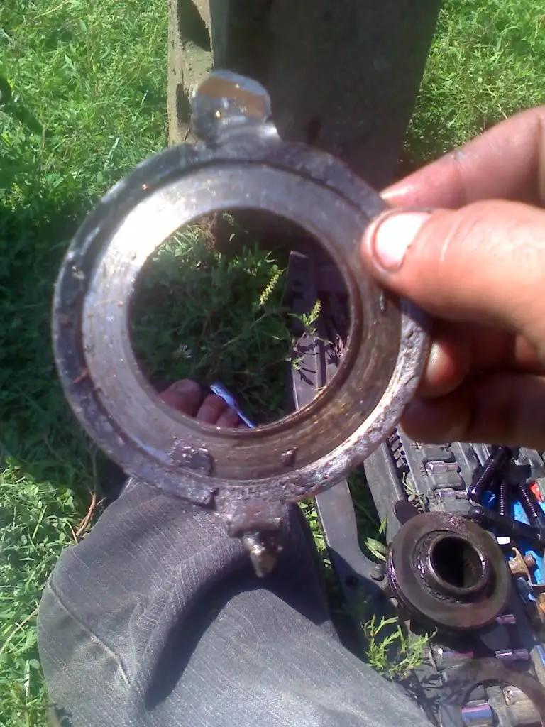

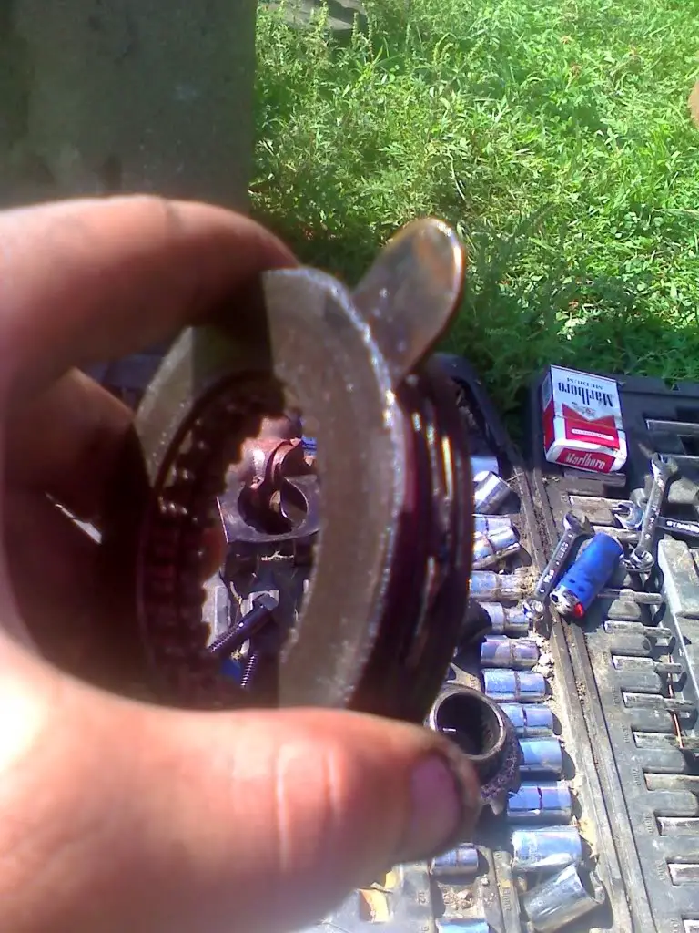

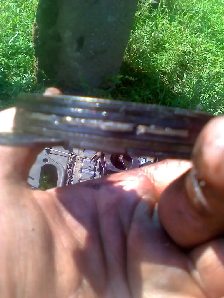

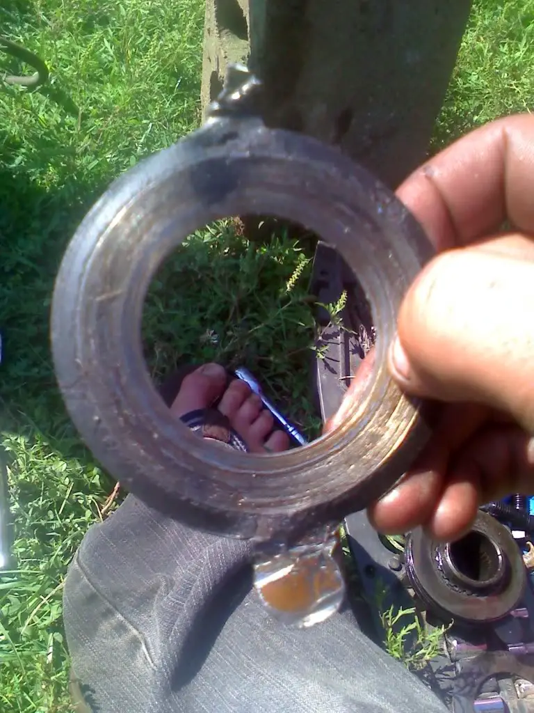

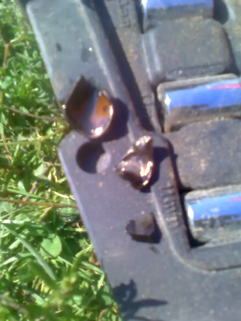

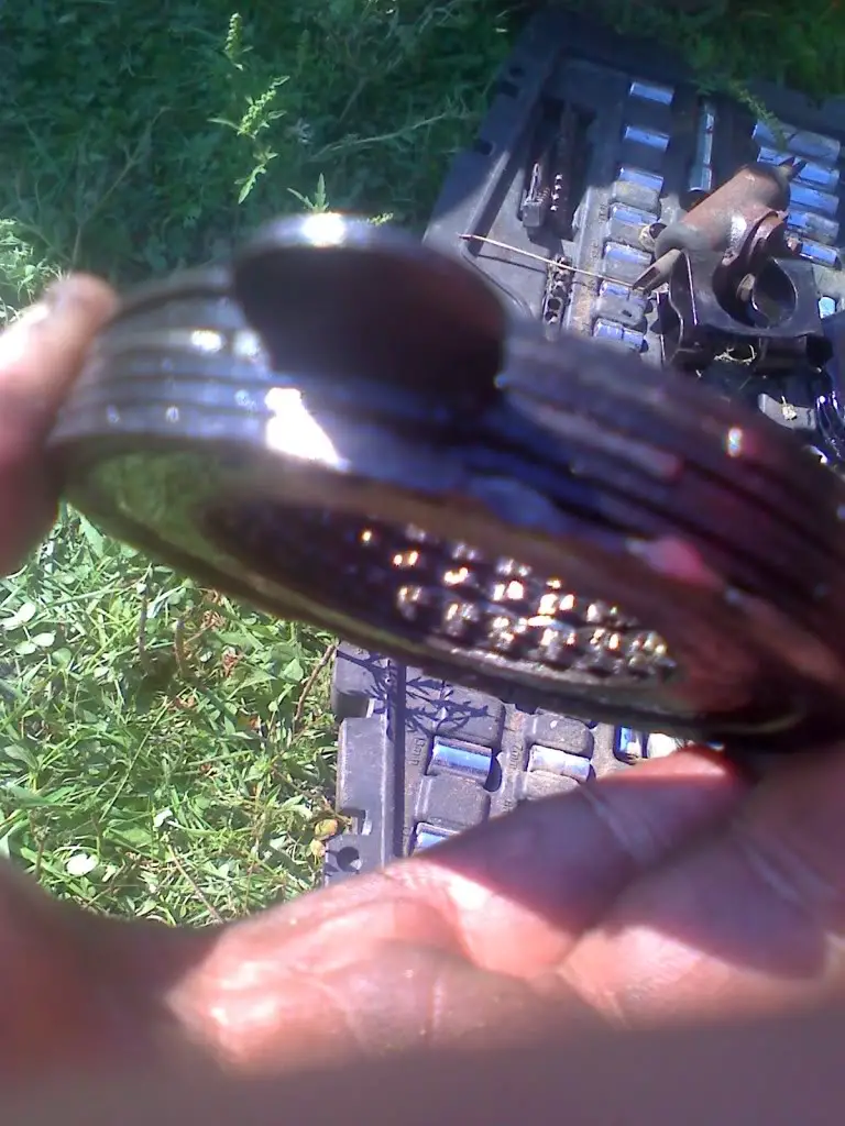

well i pulled it all apart today removed everything but the pinion, and attached to the side gears are like 6 plates per side...i wanna say those are the clutch plates (if i remember correctly but not sure) for the LS...and once again if i remember right 3 of the 6 per side should have 2 tabs on it which slide into slots on the carrier.... well i only have one per side and they are closest to the side gear (on each side) i also recovered what seems like the remains of the other tabs in the bottom of the diff...and i see what looks like where the tabs were supposed to be?...i'll post pics in a while to show exactly what im talking about could this be my problem...and i also decided to spin the pinion yoke b4 i removed the axles and it still turned one axle shaft but not the other (this is with it out from the truck and sitting on jack stands) im just lost lol so if u can help me out it'd be super appreciated thanks and i'll get on those pics since they can explain better than i know how lol thanks again
well here are my pics and there is 7 plates per side gear...the first two are the ones opposite the ring gear and the next 4 are the ones closest to the ring gear and and the final pic is of the shreads of those tabs as i call them
opposite ring gear plates
closest to ring gear plates
ones of the plates (with tabs alone) very special its mangled
and last the metal shavings (that look like the tabs from the broken plates)

I'd let some of the guys that know rear ends chime in. Those shims go bad and I know you loose your LS. Not sure you should lose your whole rear end though? Anyone have some insight on how it works back there? Also if it's just the shims that are bad I'd just replace them instead of a whole rear end or ring and pinion job. How do the spiders and the ring and pinion look?
Well, I'd say you found your problem! I see a new rear for you in my crystal ball...
well i wanna try to avoid getting a whole new rear end with this bign my problem (i hope) so if anyone knows a place i could purchase these shims/clutch plates whatever u wanna call them...and if anyone knows the actual order they go in..since there is 2 diff kinds of plates in the stack..one has the tabs the other doesnt? lemme know thanks a bunch
