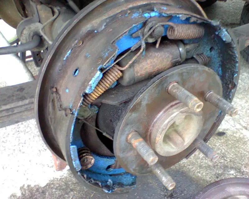

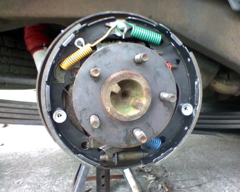

Just finished the rear brakes on my 92. Brake fluid was leaking from the passenger rear. Bad wheel cylinder was the cause of the leak. As you can tell it needed a brake job also. Replaced brakes / wheel cylinders and springs on the driver and passenger side. My question is are these the original brakes? The only reason I ask is the blue paint. I'll bleed the brakes tomorrow. Hope it's not a big issue I need my truck for work Monday.
