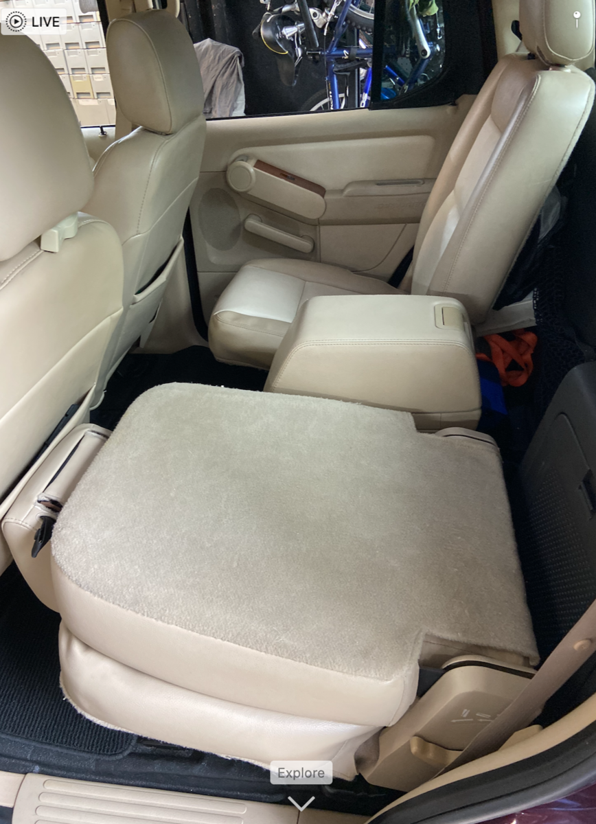

I always liked the look of the Sport Trac concept, especially the rear bucket seats. Well, I found a way to safely swap a matching set of bucket seats and console.
Here's the finished project:
Turns out the Sport Trac and regular Explorer/Mountaineer share the same seat front crossmember. The rear is slightly different but close. The extra holes are not drilled but the welded nuts are there (not tapped).

Here's some random details:
  • The left rear seat mounting holes are there except for one of the outboard bolts. I could be there under the floor pan but I just couldn't find it without drilling holes or dropping the exhaust. I did have to drill 1 hole in the floor bracket to align with one existing one.
  • On the right side I had to open some of the holes in the floor pan to expose the welded nuts on the cross member. The nuts are there but just not tapped. From what I've read they get tapped by the fastener during installation so the only thing I had to do was to drill the hole.
  • The 2 studs for the left side of the console were there but I had to expose the 2 for the right side.
  • All the seat belt mounting holes were there.
  • I used threadlock on all the bolts and sealed the new holes before final installation.
  • I had to trim one small area of the flooring at the rear inboard side of the left seat and cur 2 slits for the left side of the console. So if I ever needed to go back to stock I could. I noticed that there were features in the flooring that seemed indicate that it was modeled for this layout. For example, there are "dimples" for the new studs and the console bracket. I doubt this was really in the plans but who knows. The Ford "Way Forward" stuff at that time could of killed all sorts of engineering efforts.
  • Sourcing the parts might be the hardest part with the seat support (6L2Z-78606A50/1-GA) floor brackets being the hardest to find. I just happen to stumble on an 06 Explorer with the 2nd row bucket seats in a local junkyard and snagged everything for under $50. The seat covers were trashed but I found another set I could use. I went back and measured the mounting holes and matched them with my truck. I even cut into the other vehicles floor pan to see the cross members and all.
All and all the installations was really easy and well worth it. My wife says it's a lot more comfortable and having the console it a big plus.

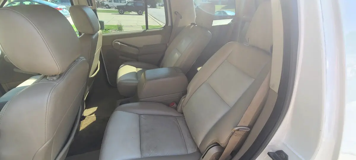

I have an 07 Explorer Limited and I have bucket seats with a console in it. I have only owned for short while. I do know the previous owners though. I dont know if this was done custom or factory. I really like it and so do passengers that ride in the back. It looks good too.
