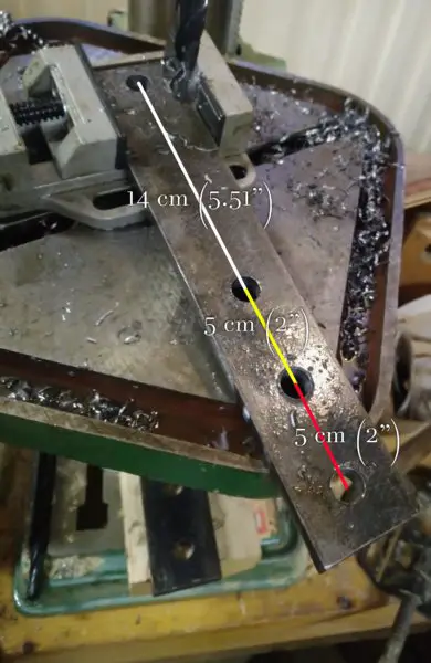

Stupid easy to make them your self as well, buy new bolts from hardware store.
I used 1cm (0.39") thick material, which is quite the overkill, could probably use half of that.
and because i used too thick material i had to buy longer bolts (oem wouldn't do anymore).
Below picture of too short bolts and installation with bottle jack, i later added longer bolts and bolts to all of the holes to increase rigidity.
