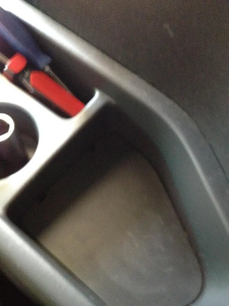

5. Remove the upper nut. Inside the vehicle, the storage trays have a removable piece of plastic you can pop out with a flat head screwdriver. Hold the nut steady with an open ended wrench and spin the stud with a socket. You will need an extension for the socket.
