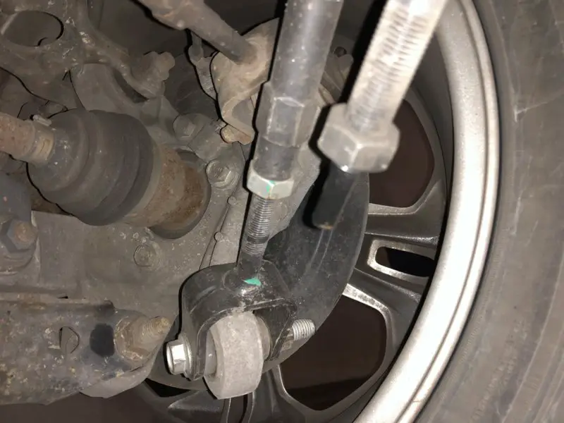

Today the left REPLACED! Toe link broke. Just while normal highway braking in front of a traffic light. We drove around 4000 km / 2500 mi since the change.
The suffix J is the Toe Link Kit. This includes screws and both links.
Someone from USA posted a photo as far as I remember this shows the CE suffix as well.
My guessing is, they tightened the screws with the car on the hoist, instead while sitting on the ground.

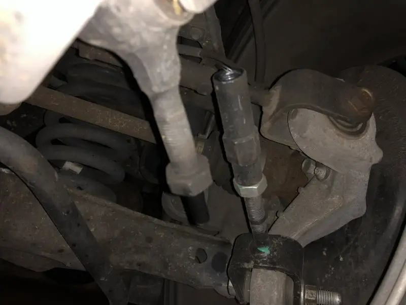

Today I got my Explorer back.
The dealer was very courteous, while my wife picked the car up. I didn't have to pay anything nor for work, parts or rental car.
At home I took a look, and I know why. They replaced the wrong link with the correct part.
In the first step, they exchanged the BB5Z-5500-A solid arm with the "Toe Link". The toe link is shorter than the trailing arm, therefor it broke after 2500mi
I took a picture. Now they replaced the trailing arm, with a new trailing arm, and in the end, they replaced the toe links as intended in the recall.

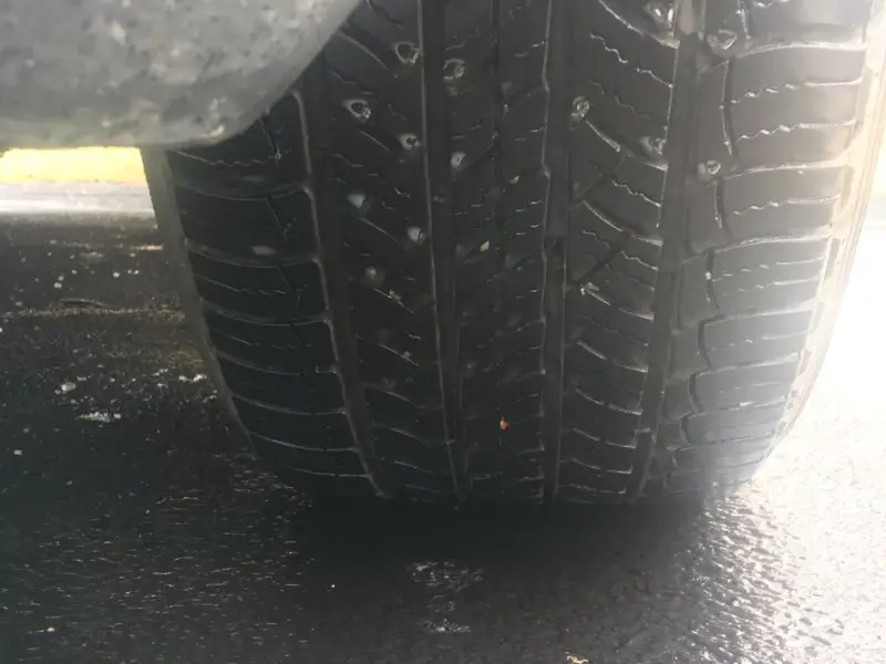

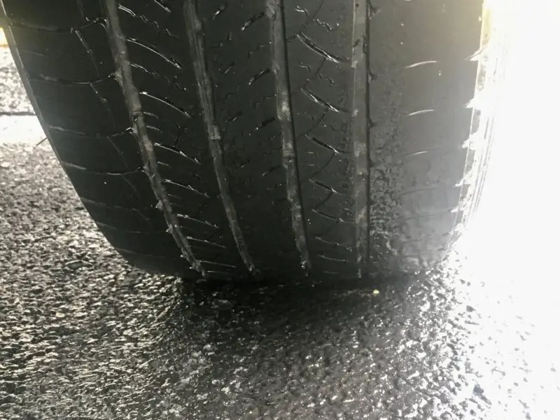

Hi everyone, I haven’t introduced myself yet but I have been a member and have creeped on the forums for sometime now since obtaining our exploder in June of this year.
I have encountered a problem where with the vehicle purchase (2013 with 92,000) and new tires/alignment when purchased, I had the recall performed a few months later as well with in oil change and tire rotation. This was performed around 96,000 miles and now around 100,000 in the rear tires are shot due to inward toe wear. Per the work performed it is mentioned that per the Ford FSA an alignment was not needed, these were basically brand new tires and now I have to replace all four. The tires that were originally on the rear and changed to the front at 96,000 miles are perfect so I know that there was no inward toe issue before the recall service was performed.
Does someone have a copy of this FSA because I really feel that there should’ve been an alignment done.
The issue now pertains that Ford will not honor new tire as I do not have a tire wear warranty type ‘ Program’. Really it should be the dealer that faces the issue since they performed the work and did not do an alignment after the rear toe links were installed. The service manager denied it and the general manager or also the owner said that your vehicle is too high of mileage so I am not honoring that. Basically I am screwed and have to pay for new tires, Mount\balance, and alignment, where are the tires were brand new in June. I probably have to take them to small claims court but I need proof that the FSA does call for an alignment, the press release says “align quote but I don’t know if that is enough to hold up in court.
I recall it saying a rear alignment was required after the toe link replacement. Any dealer should know you have to do an alignment if you replace these. I would definitely threaten to sue them. They'll give, because they know they were in the wrong.
On mine they checked the alignment and did a 4 wheel alignment at a discount.
I don't believe that a alignment was part of the work for the recall. But it should of been.
