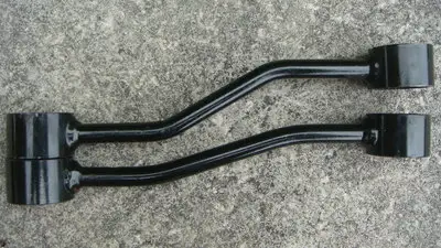

This is the problem with making a purchase based on price alone. Amazon often drop ships and splits shipments from vendors. The
first pic is what's shown on their site. Second is the comparison of two Moog K80101 end links received in identical boxes. I'm certain
this partially contributed to my offset issue. Never had them side by side since they arrived four days apart. Also torched the pressed in
bushings so no return. USPS Flat Rate would also exceed the $9 price.
Amazon accepts returns for defective items or items not as described, and they eat the shipping.
I would use this option and have them send a replacement. (They offer you the option of a refund, or a replacement, the replacement
is less hassle since that shows you really want the item, not just your money back) The link that isn't bent correctly is clearly shorter as well.
You didn't get what you ordered, I would send it back, either without the bushings, or with new rubber bushings pressed in if you want.
You could try dealing with Moog directly as well, but I'm pretty sure they'd tell you to handle it though the place you bought their product from.

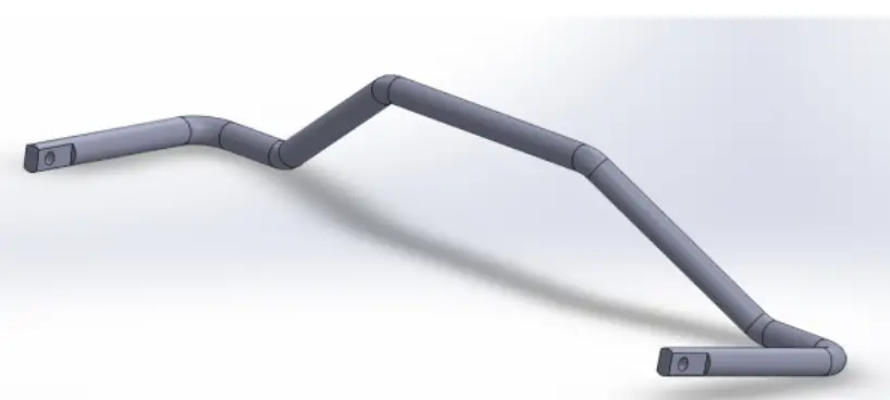

The Addco directions are kind of fuzzy as to whether the center bend goes towards the top or the bottom as you bolt it to the axle; the engineering drawing shows it with the bend at the rear axle cover oriented towards the top (which necessitates trimming the spare tire bracket - no biggie with a Sawzall). Another peculiarity that seems to reinforce the top-facing orientation is that the middle bend at the inspection cover is offset about an inch, which would suggest the bar is bent with the intent of it being installed per the engineering drawing with the bend facing up. There is still enough clearance for the "pumpkin" either way, but if you stare at it long enough you realize it is non-symmetrical, made even more so by the fact that these Explorers have the engine and axle carriers offset to the passenger side. Despite this, I finally realized (after trimming the spare tire bracket) that I wanted to see the rear sway bar from behind, so I turned it to more closely mimic the factory sway bar location. After all, no matter which way you turn the bar, the clearance and fitment issue lies with the width between the arms that extend towards the rear (which want to hit the shocks); and, since there is no extra horizontal bends in the arms themselves once they depart from their 90 degree bend at the axle, the height distance between the end link brackets does not change with orientation.
I owe member swshawaii an eternal debt of gratitude for posting the pictures and info concerning the Moog "K80268 F250/350 SD 4WD" part number and picture, as well as the "Energy Suspension 4.5153 polyurethane kit" info; with the lack of bends in the Addco bar, you have to use these shorter end links to pull the sway bar ends up enough to clear the shocks (even with the stock ride height, the factory end links are too long with the Addco bar). The Energy Suspension kit comes with extra washers, 2-3 on each side of which will be needed to take up the space between where the end links hang "at rest" and the width of the bar; Ideally, this necessitates two new 12mm x 1.75 pitch bolts which need to be 5-10mm longer than the stock bolts that fasten between the holes at the bar arms and the end links, so the new bolts should probably be 70-75 mm long.
Another thing that I noticed from Addco's engineering drawing for the #633 bar is that there is a slight difference in height between the two sides:
Evidently, there is a difference in the height of the mounting holes at the vehicle frame, since the end links for either side have the same part number; once you bolt the end links to the car, the holes lined up perfectly.
