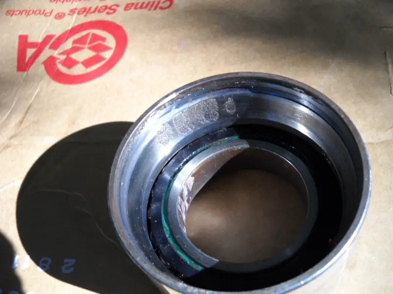

Well I finally got bitten by the rear wheel bearing bug. What a pain!! Both bearings were bad. Main symptom I had was noise, though about a month a go I developed an occassioanl "sway" feeling in the rear end. I finally had my wife drive the truck and me follow her, and when doing this I could actually see the left rear tire wobble a bit at the same time she was feeling the "sway" while she was driving. I had a shop do all of the work (not mechanical myself). Total for both rear bearings and a 4 wheel alignment was $1228, including sales tax. Truck only has 85k miles, though it is a 2004. It is our weekend/travle vehicle. This is actually our first real repair on it, so I guess I can't complain too much, but what an EXPENSIVE issue to have due to a bad design!! And related, the shop I use had trouble diagnosing because when I initially brought the truck in they put it up on the rack and everything was solid, no wiggle in the tires, nothing. But after a month of it getting a bit worse (and me leaving them some notes of the symptioms we were having)they were finally able to see the wobble when the truck was on the rack and they were running it. Left bearing was toast, right was not far behind. Venting over now. lol!!
