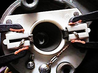

With help of this thread Im back to having 4wd again woohoo this write up is the best. I do have a suggestion however when I was installing the brushes in the motor. I was having trouble holding them in and putting the rotor in at the same time. I took 2 small zip ties and used those to hold the brushes in till I got the rotor in. Then I used my side cutters and cut the ties off and pulled them out. It took a couple of extra minutes but was alot easier than trying to chase a wayward spring around the shop floor.
...I do have a suggestion however when I was installing the brushes in the motor. I was having trouble holding them in and putting the rotor in at the same time. I took 2 small zip ties and used those to hold the brushes in till I got the rotor in. Then I used my side cutters and cut the ties off and pulled them out. It took a couple of extra minutes but was alot easier than trying to chase a wayward spring around the shop floor.
Thanks for the suggestion.. it is notable and will help others attempting this fix. When attempting to re-install my armature it was slightly tricky as you needed three hands to do it.. I used a couple of plastic hobby spring clamps as seen in the left picture below. These were strong enough to hold the brushes, but small enough so the armature and housing could be installed.

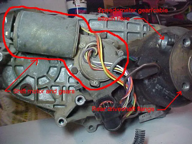

Ready to do the fix, but found that the sensor is covered with oily black metal filings.
What is the purpose of the sensor and how significant is it to have filings on this sensor. Seems like it is magnetic.
Is this a speed sensor? Why required when there is a cable going to the speedometer. Is the speed sensor for the computer?
thanks for any info
I assume you're talking about the shift motor speed sensor located in the following pic... The sensor is magnetic and you can clean off the metal filings and re-install. Did you read the Shift motor rebuild thread?
