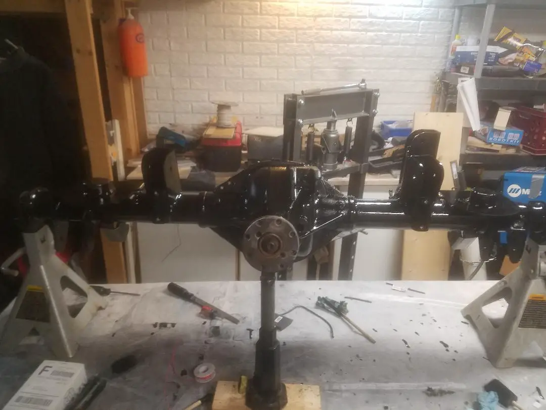

Attached below is my progress, a little more done since this picture. All of my TJ brackets are welded into place, everything is painted (chasis saver follow by a top coat). New bearings and seals. All hard and soft brake lines are plumbed (removed for painting). Reassembling now, that is when I got the bolt question. All new rotors, pads and shoes showed up over the weekend, new wheel studs should be here tomorrow. The next thing on my to do list is replace the clutches, due to the stink, that will have to be done in the garage, when the temps go up a bit.
Thanks,
John

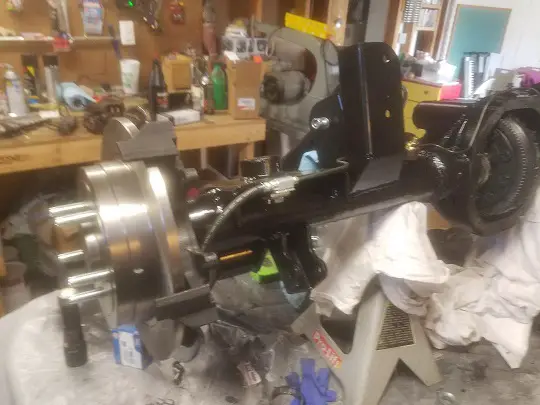

Here are my latest pics...
Thanks.
John

Completed the TracLok rebuild last night. Use of the needle nose pliers to insert spring was easier than I thought it would be. Went better than I expected. I will be adding the remainder of the friction modifier tonight and the gear lube. Cleaning up and painting calipers tonight as well. Mount rotors, pads and calipers tomorrow night and she is ready for install.

Completed brake install and put rear cover on. Hitting underside of Jeep with PB Blaster regularly, got to say the bolts are pretty rust free.
Thanks again for everyone's help. Will post more pics when I have the thing mounted.
