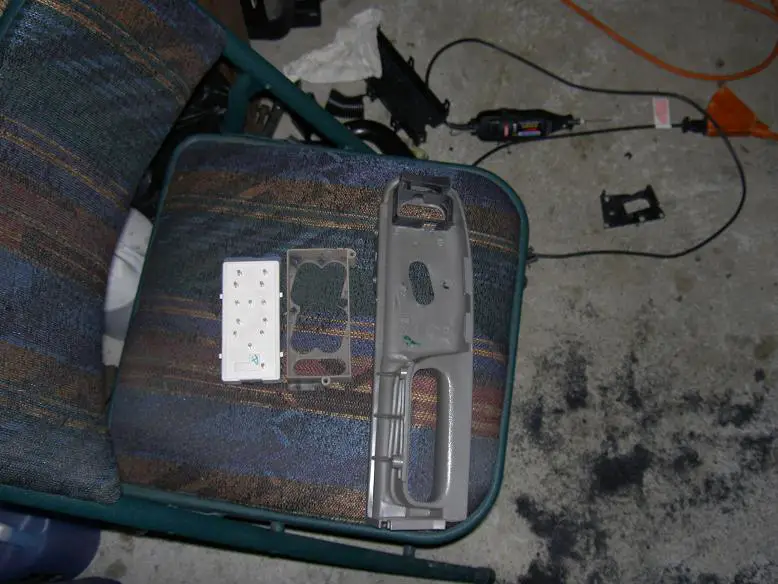

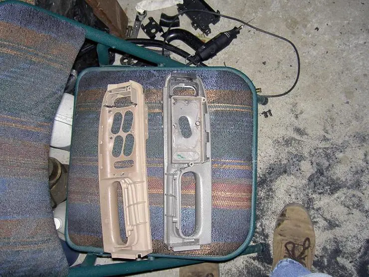

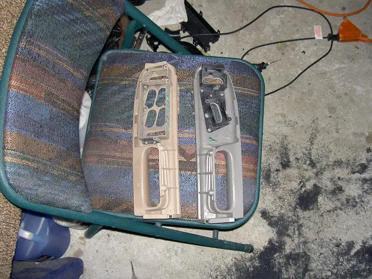

I take that as a compliment, because I actually cut up the RF switch panel, and merged it with a LF underside switch holder. It took a couple of hours of tedious cutting and epoxying. Regards,

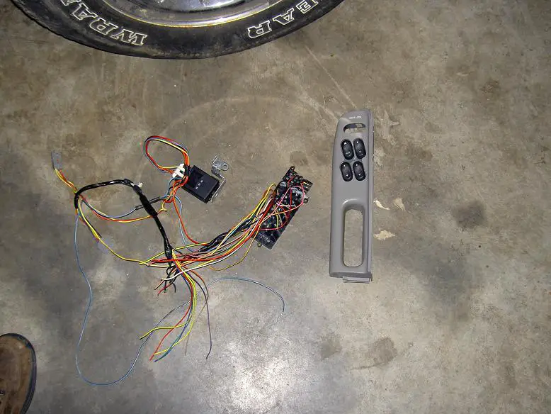

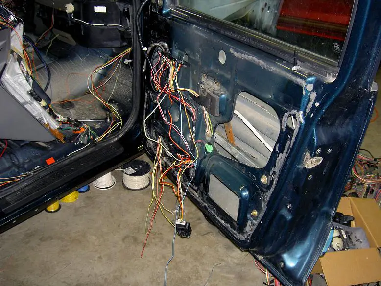

The one touch feature is inside the GEM module starting in the 95's I believe. To add that feature to any window, up or down, you can use an auto down module from a mid 90's Taurus etc. The Explorer had those in 1993 and 94, I used that one for my RF window, it's a small device about 3"x2"x1", and has four wires to it;

With your helpful advice, I did get the window master switch out, tested with an ohmmeter, all switches behave the same resistance wise, including the top left one that doesn't actually move the driver's window up...I guess unplug the motor and apply 12v to it next to see if it moves...I'd read here in the forum that the separate 'one touch' unit could be bypassed IF it was causing the problem. I'm hoping it's NOT the GEM module causing it, would have no idea how to fix or replace that! I'd also seen on You Tube a guy manually pulling up a window that wouldn't go up with the switch, found out there was NO budging it a millimeter. I've worked on 'roll up' windows a few times, this is the first try at a power window.
The switches are extremely fragile inside, the contacts are tiny and it's lucky to have them last 1-20 years. If one is ever old and may be a problem, I prefer to replace them since they need it anyway.
You can unplug the motors and apply +/- to the wires, either way, to test them. The switches apply both power and ground to a motor to make it run. All of the wires are normally grounded, except the main power wires.
