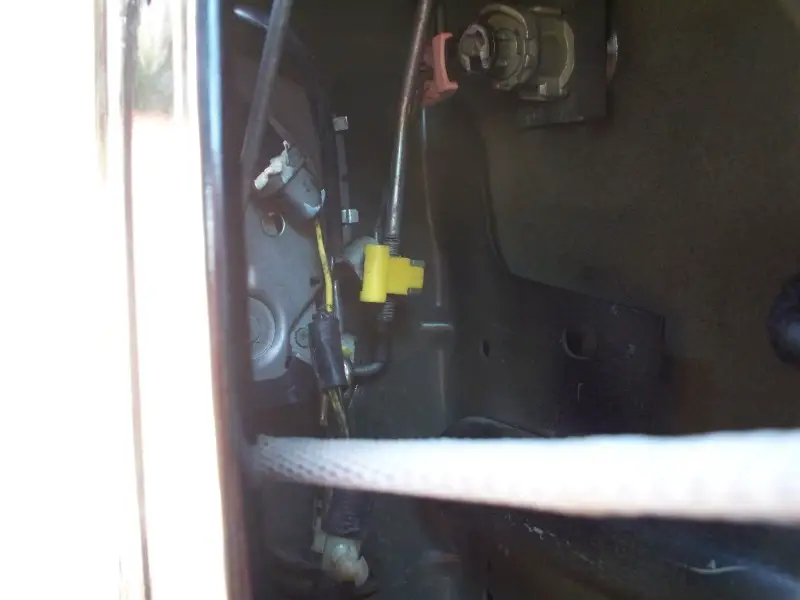

I just did mine today and this writeup was very helpful. Two areas were a bit of a problem: the outer door handle rod and getting the latch separated from the power solenoid.
The outer latch rod attaches to the yellow clip and I was a bit confused how to get them apart. I discovered the yellow clip opens like a door with the "hinge" on the inside side of the door and the latch part on the door skin side. The photos show the clip open and closed.
Getting the latch out of the door is a bit fussy and took several tries but it came without bending or breaking anything. Oddly, getting it back in was easier than getting it out. I think if the solenoid was removed it would make the whole procedure much easier. If I ever do it again, I'll drill out the rivet. The whole thing start to finish took just under an hour not including putting my tools away.
