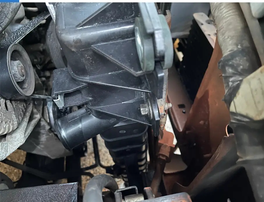

This thread was essential to allow me to change the radiator on my 1999 5.0 Explorer today. A few undocumented problems I encountered were:
  1. 10mm bolt hold evaporator to radiator. I don't think this was shown in the original pics and it took me several minutes to determine this was why I could not get the evaporator free from the radiator. Its on the passenger side, near the top of the radiator.
  3. Attaching the evaporator to the new radiator was really difficult. I could not get the male clips on the drivers side into their mates on the radiator. I had to lift the radiator out of the support and push it back toward the engine to open up enough space to maneuver the evaporator into the clips. I also removed the plastic cover above the grill, the one with doors to access the headlight bulbs, so that I could get a hand on the evaporator and guide the clips into the mates on the radiator. Then I lifted the evaporator/radiator assembly into place on the support brackets.
I just replaced the radiator on my son's '97 Mountaineer, and get to do it all over again because the new radiator leaks, has the wrong tank on the passenger side (doesn't have the slot for the bottom clip or the ear for the top bolt to connect the condenser), plus other problems. Removing the cover above the grille is very helpful. I also found plastic air deflectors snapped to the bottom of each side of the condenser tend to hang up and limit the upward travel of the condenser on installation of the radiator. I went out to remove the new leaking radiator this afternoon, and had it ready to lift out in a very short time. Knowing which direction to move everything certainly helps. I didn't see this thread until now. Another good thread, not quite as good as this one, is - Removing radiator from condensor on a 5.0?
