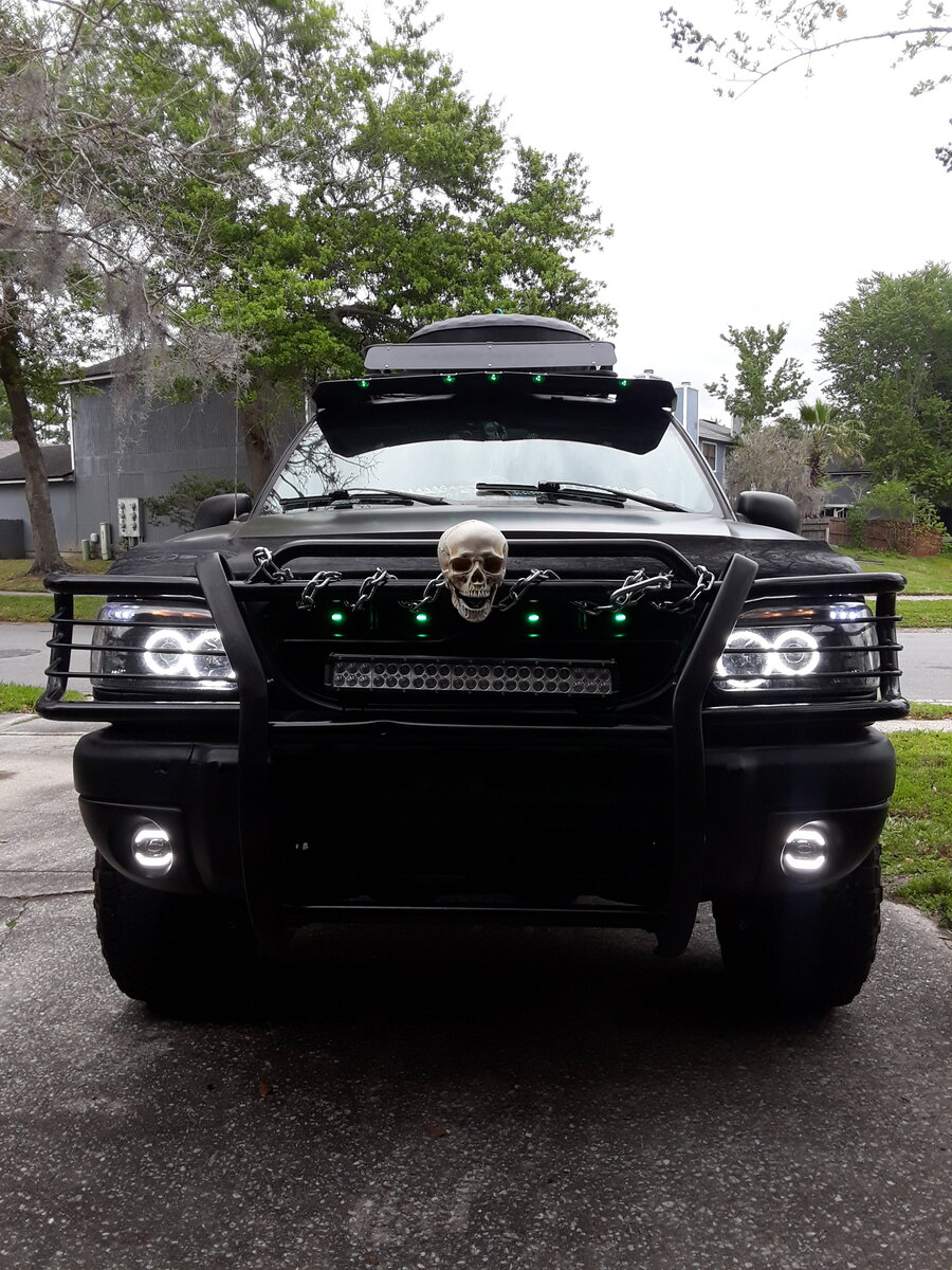

This was my DRL setup after all the light upgrades. Visor, grille, fogs, and halos; all hooked to the switch for DRLs, looked so nice, just those and no headlights being on constantly; going to miss that setup. Feel free to ask more light questions too, I've done and still am doing way too much lighting wise 😅
