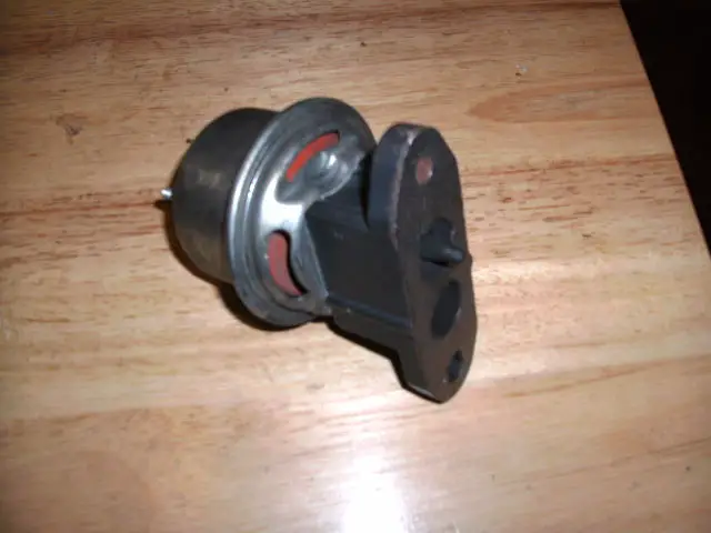

OK I got the 02 sensor fixed, now it's time to find the EGR problem. I want to remove the EGR. Can this be removed by itself without removing the housing that covers the ports? The tranny tube is very close and it has the sensor on the back of the EGR. Also, the bottom bolt is hard to get to and there's very little room.
I took the vacuum line off of the control valve and run it directly to the EGR and the engine didn't change so the EGR must be stuck.
