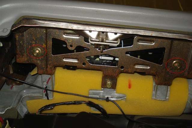

I have removed mine from my 96 a couple times very easy, probably five minutes.
drop your glove box down, then look up into it
you will see those two screws. undo them, and the connector, and it should come right out.
