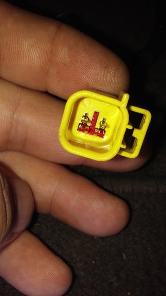

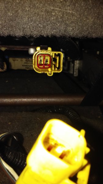

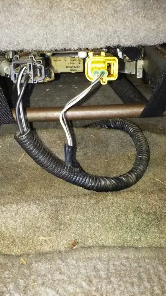

Hope it works out if not ill add some pics of soldering it in because if it don't work on yours it's only a matter of time on mine and I didn't think of soldering it

Well it's been 3+ weeks now and still no return of the dreaded airbag warning light since applying the WD40 to the resistor. I'm going to call this fix confirmed.

I just tried it yesterday with the WD40 and no luck for me. The light just continued blinking and stayed on. So i guess i’ll continue to drive with this annoyance.
I'm going on 3 full months as of 12/1 since applying the WD40 and the air-big light has not come back on again. Thanks for the tip @donalds. Not quite sure why this worked, but glad not to see that stupid light every time I get in the vehicle.
