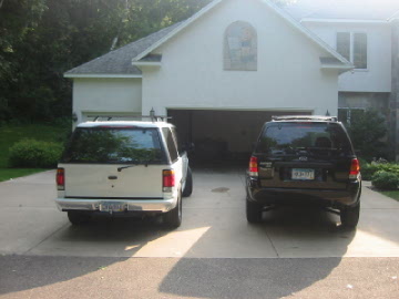

they also have the little holes you are thinking they have. mine are filled with metal- which isn't cheap, but bondo plus a big system and cold winters and bumpy roads just didn't seem like a great idea. i think there were a total of 4 or 5 little holes.
