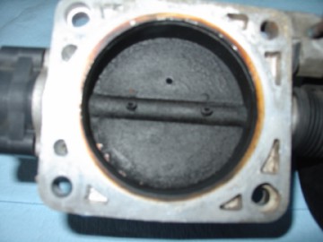

Well. it appears that I was not cleaning the rear of the throttle plate by this method. ( http://www.explorerforum.com/forums/showthread.php?t=139457 )
I now have to say you need to remove the TB to do a proper cleaning.
