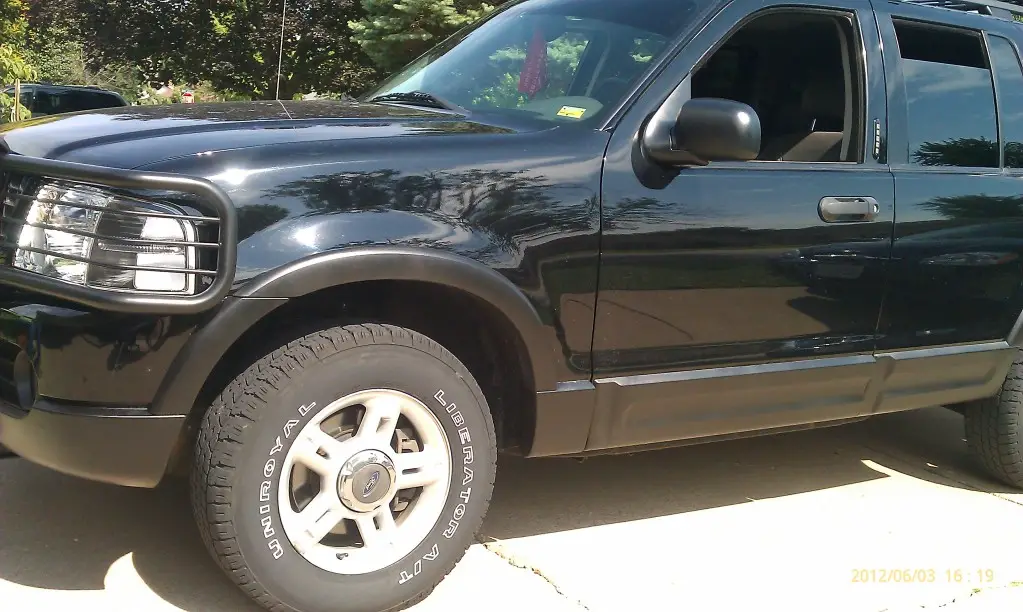

Here is a couple shots of my Ex with the trim painted.

Well I did take the bumpers off to paint them, but I did just used newpaper and painters tape on the side panels on the doors. Mostly because I got the rear drivers side door panel off, and decided it would be a major pain to take them all off. But they are all just held on by clips, I used a small crows foot with a towel wrapped around it to avoid scratching paint. Probably 5 to 6 clips per panel. but there was no double sided tape. Very easy to take off. Sorry didn't grab any pictures though. Hope it ain't bad i went crazy with the spray limited.

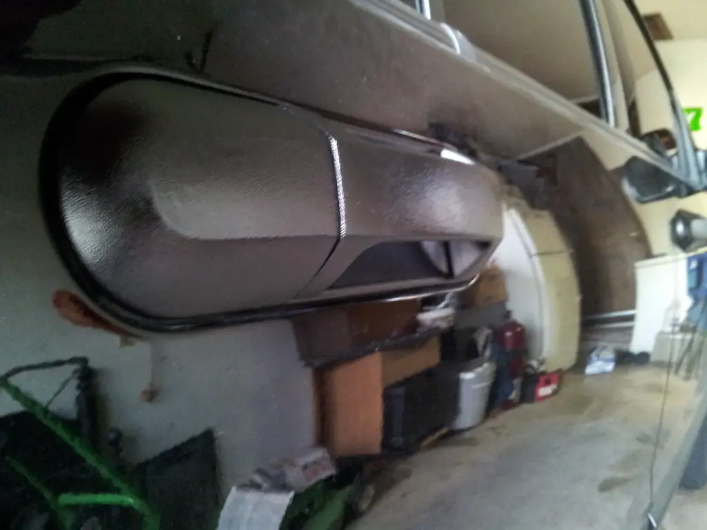

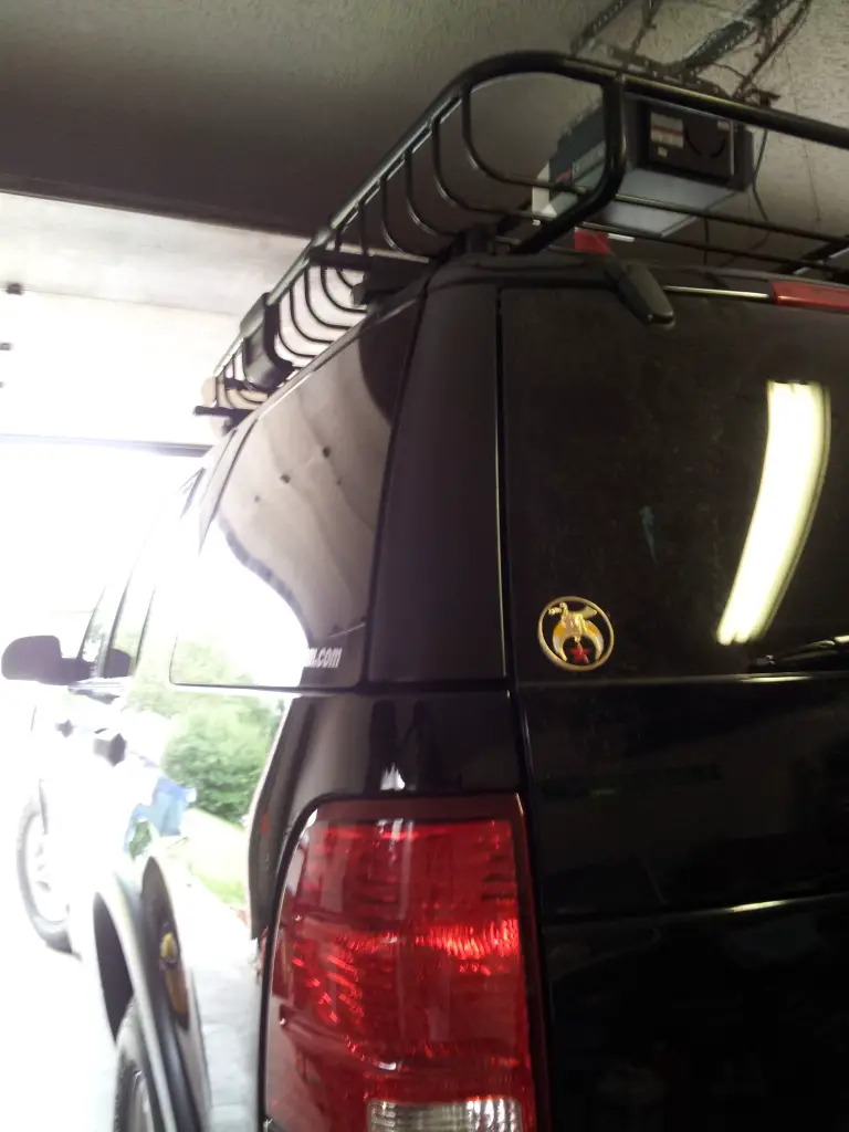

as well as the plastic trim, I also did my door pillars and door handles. Here is a couple shots of them.
and this last one shows the contrast between the gloss that comes from the factory, to the Krylon Satin black I used.
