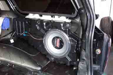

I cramed a 10 in there but I am having issues with the tuning of the box as well as a helluva lot of rattle.
I also have a aftermarket amp in there.
Doing the swap was easy since I upgraded the whole system.
With the stock HU I believe you will need an amp by pass harness.
Beyond that it is all a matter of allowing your self plenty of time to do the job right. take the seats out and all that. Do a nice neat clean job.
It took me almost three days for a total instal, two amps, a distro, four speakers, two tweets, a sub, a hu, a 6-disc change and an eq.
Take your time and do every thing right the first time.
