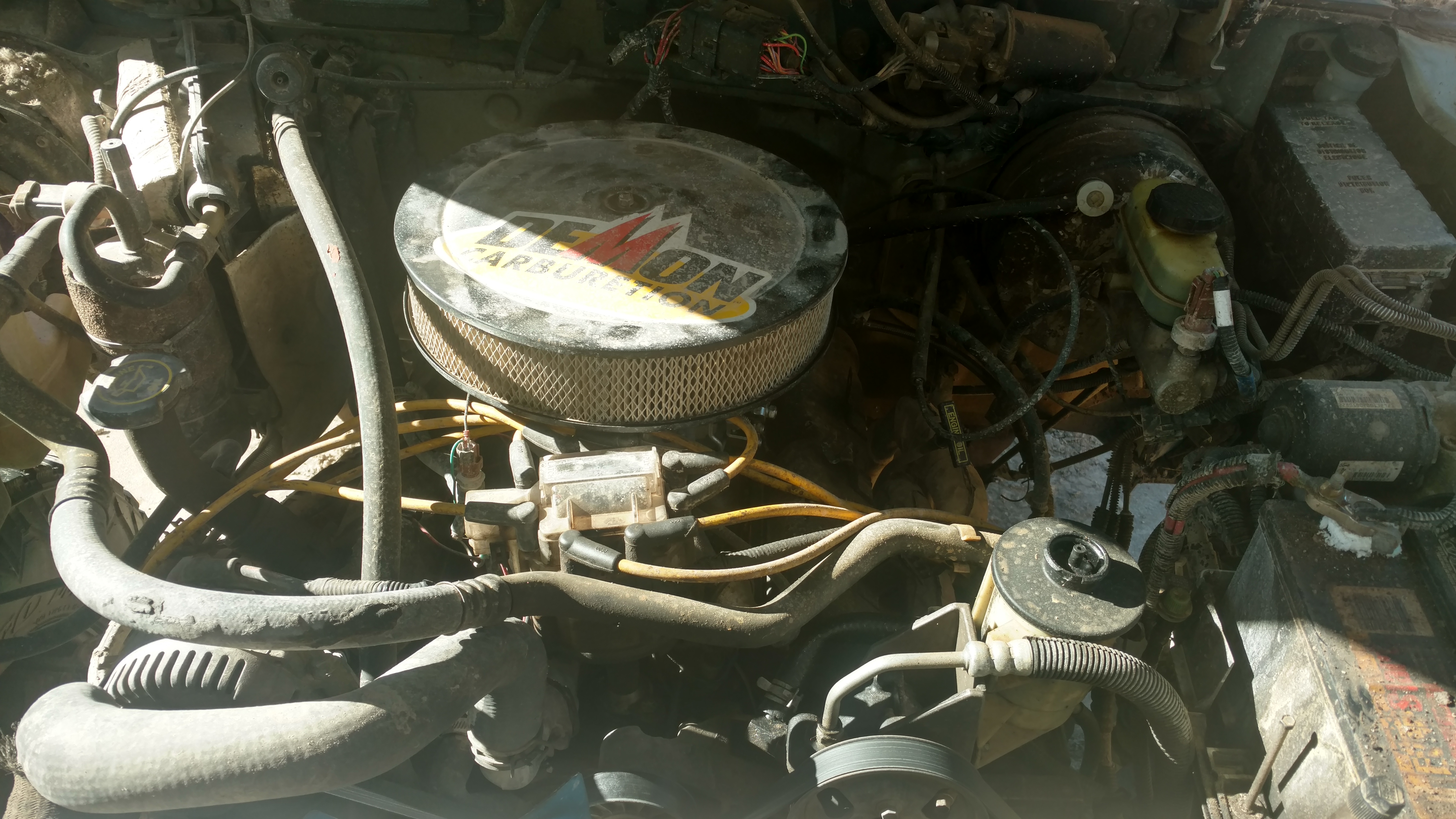

It's actually cheaper than you think to swap it with an older 302 I did it to mine the only downside is the gas mileage changes drastically and I don't have to try spending all day troubleshooting when something goes wrong
So what gets worse mileage than a Ford Explorer? A V8 carbureted beast Ford Explorer!
Did you go all the way back to distributor and points?
I did I went to a gm style dizzy a street daemon 625 carb eddlebrock 289 torquer intake custom exhaust ect. And I think it runs much better than it did with efi.
Mine is a beast probably the best thing I did to it though
Do you get more than 8 or 9 mpg?
Picture not working. :(
I get 11mpg in town and 9mpg on the highway but if I had OEM tires on it I would prob get a lil better then that
I get a bit better than that but I also changed out my gears for the bigger tires.
