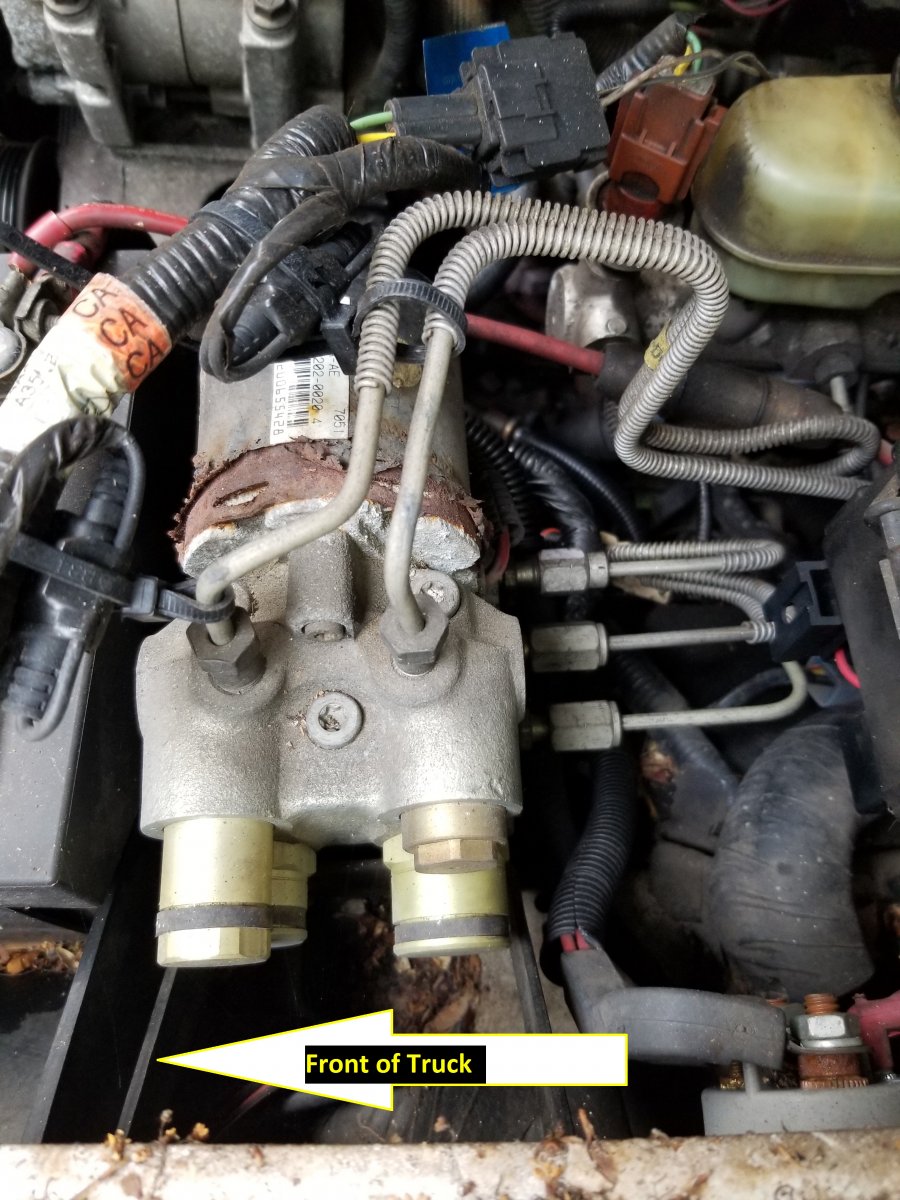

I don't recall the ABS fittings size, know it is larger than the fittings for other brake hard lines and probably metric. I just reused mine, although the hard lines themselves and fittings at the wheel calipers were rusting out, those fittings on the ABS module were in good shape still. Yours look like they may be reusable too. On mine, they screwed into a second fitting barely sticking out of the ABS module so I put a second wrench on the lower fitting to keep it still while the upper was taken off and put back on.
Hey guys, i didn’t see any definitive answers on what size/type of fittings those 3 are going to the ABS in this picture. If I missed it my bad, I don’t use forums often and I’ve never revived a semi-old thread. I would seriously appreciate a definitive answer. Thanks!View attachment 453855
I just reused the fitting. I believe the brake line end are bubble flare ends (ABS module) and there are short flex brake line, in the lines also.
