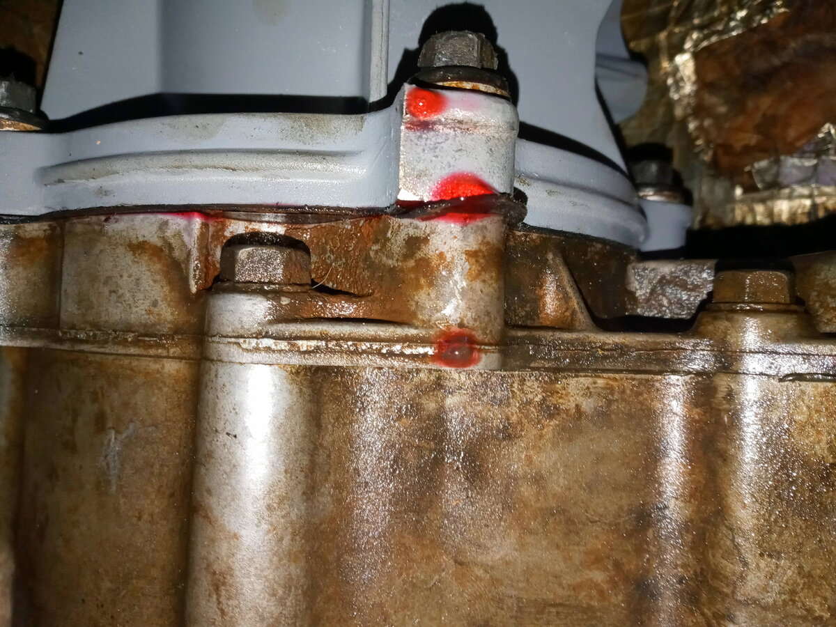

Just Replaced Engine and Transmission in 03 Sport Trac 4WD
What is the Process of Replacing Gasket ?
(The Gasket on there is Leaking ; It is a Traced Gasket from a roll of Gasket; I know ...I Know... O'Reillys didn't have the Gasket and me and a buddy were ready to wrap up Job after 2 months of full weekends doing both jobs)
Will I have to Drain All Tranny Fluid ?
(just spent over $100.00 on OEM Mercon Fluid)
Is it as simple as unbolting both drive shafts and unbolting Transfer case from Transmission ?
Thanks in Advance

Not sure about Sport Trac; my '04 XLS has an oil seal on transmission output shaft, oil seal on transfer case input shaft, and it appears that a leak between the two MUST mean a leaking oil seal, gasket or no gasket.

This Leak is 100% coming from the Gasket in Between Transfer Case and End of Transmission (Park Pawl).

Look closely at this adaptor:
The cavity between the transmission and transfer case has a WEEP HOLE placed in it at the factory. This is how my '04 is made. No gasket, unless dust is a consideration, you can include one if you like (I siliconed it). Any leakage HAS to be seal leakage, either trans. fluid or transfer case. I noted that the t-case input shaft seal had 2 LIPS, to exclude leaked transmission fluid from getting into the t-case past it's sealing lip. The right side faces the t-case interior. This is not to say ALL explorers are this way.

I’ve separated and removed a 1354 from a manual trans on two Rangers and there was no real fluid loss. Trans is sealed and tcase is sealed, with a dry gasket between.

I replaced gasket today ....used RTV on both sides of it ....Leak Gone.
