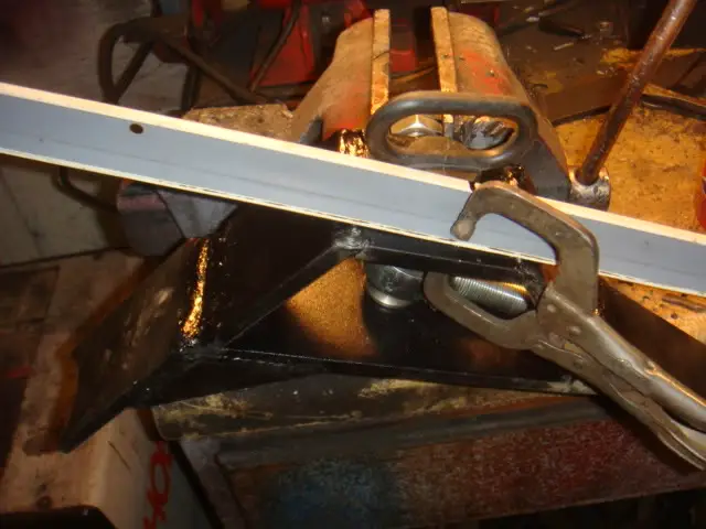

36" from center of bolt to outside of tire, I'll get 20" of vertical travel.
All I did was to put a bolt on end of heim in a vice and cycled it.
Have to see how this works out on the trails/rocks.
As you would guess there is zero bind.
This amount of travel will put the tire up against the top inside of wheel well.

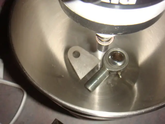

also I must have missed why you picked to build a modified 4 link instead of a true three upper mount that has 1 link. doesn't two upper links induce more adjustment into the mix? I would think a single upper link from a solid inverted Y would be stronger in the end.

I may not answer your question right but the upper Y will only have 3 mounting points...one on each frame and a single mounting point with only one bolt at rear. There will be only 3 bolts connecting the Y
Even though there are two heims stacked on top of each other, The true pivot point is a single vertical point drawn thru the middle of the 3/4" bolt.
I'll adjust the two uppers so that each one will put just a little preload on the bolt.
When you look at this Y you see both links converging just before the small piece that is going noth and south.
My idea wether right or wrong will have the Instant center directly in the center of the bolt not 6 or 8" in front. That little north south pices creates a dog leg that does not put the extreme amount of force directly to the center axis of the bolt as well as a true V. Picture the bolt at the bottom ofthe V. And let's say 600 #s pushing on the left angled leg towards pumkin as opposed to the same amount of latteral force being applied to the left side leg of a Y configuration. So now that angle about 6 or so inches in front of the pivoting point on the pumkin does not take the force directly to the direct center of the bolt.
Bottom line. Probably does not amount to a pile of beans anyway one way or the other but it sounds good LOL
But you just gave me an idea where I might just add brackets for an upper two link configuration. Hmmm.

From what I have seen of upper three links before your able to brace it better with a Y link top.
I think with your upper link setup you are actually weaker than a normal Y-link setup. You only have the two links going from frame to axle. Instead of a swing arm that is cross braced so that the force is able to transfer between the mounting points on the frame. Making the upper link mount a point that is not able to move side to side. Only up and down.
It may not matter right now with your weight of vehicle and the power that you are putting down now.
It might matter in the future with your gear reduction of the Atlas and if you take it in the rocks.
Good point. May have to do that. Be simple just to put a brace from side to side like your diagram and still keep the one bolt thru both heims. I'll try it first like it is and check on latteral movement of axle.
Or Might just make two more tabs, one on either side of the single bolt just in case it does need to be attached in two seperate locations. In fact while the axle brace is not yet welded on the axle that is just what I'm going to do.
Then it would be no big deal to unbolt the single bolt and then spread the two links out a few inches further if out. Again starting with the one bolt.
Having multiable hook-up points is a good idea anyway in tuning any linked suspension.
Then with the top two spread out \ / this would give a 4 pt |\ /| ?
Then there would be no piece up top going from side to side either -
One thing for sure, if I don't try it both ways I'll never know how each works and then it's just one of those things one could disagree with untill the cows come home like so many things on the webb.
