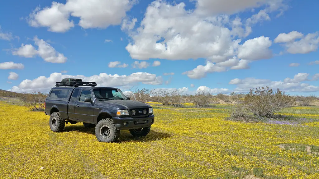

Long story short I've installed explorer roof rack rails on my ranger's camper shell to mount my cargo basket on and the OEM cross bars managed to snap with a spare tire in the cargo basket. The 3 piece design is pretty crappy so im now looking for a stronger alternative so im here to see what explorer owners do when they decide to upgrade their roof rack cross bars.
What my truck looked like about 15 minutes before they failed
