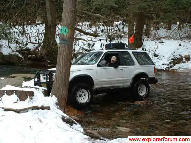

i bought a set of ratchet straps from walmart for ten bucks and thats what i use to hold my spare to the roof.
Namitey:
All you're holding it on with is straps? The straps connected to your roof rack or something?
Pics would be awesome.
Thanks
this is the best pic i can find of it right now but i just used ratchet straps to hold it down to the roof.
I like what you've done with your truck. I think im gonna do my idea with the supports then use the ratchet straps to secure it tightly. (it'll look cool :afro: )
One thing: do you leave it like that for highway driving? is it good like that for anytime driving? I do have the wind deflector on my rack so that should help.
BTW: cant wait to offroad with you dude, i just about fisnished my lift. It looks really good now and im gonna order AAL's just so my rear sits a little higher than the front. Then i get tires in March and im done.
I leave the tire on the roof all the time doesnt really bother me. Im building a new rear bumper with a spare tire carrier I just need to get a tubing bender before i can finish it.
