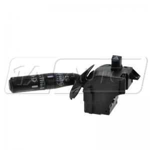

The cruise control disengaging when you use (touch, wiggle, bump,) the turns or wipers is a bad turn switch: Very common $65 easy to replace.

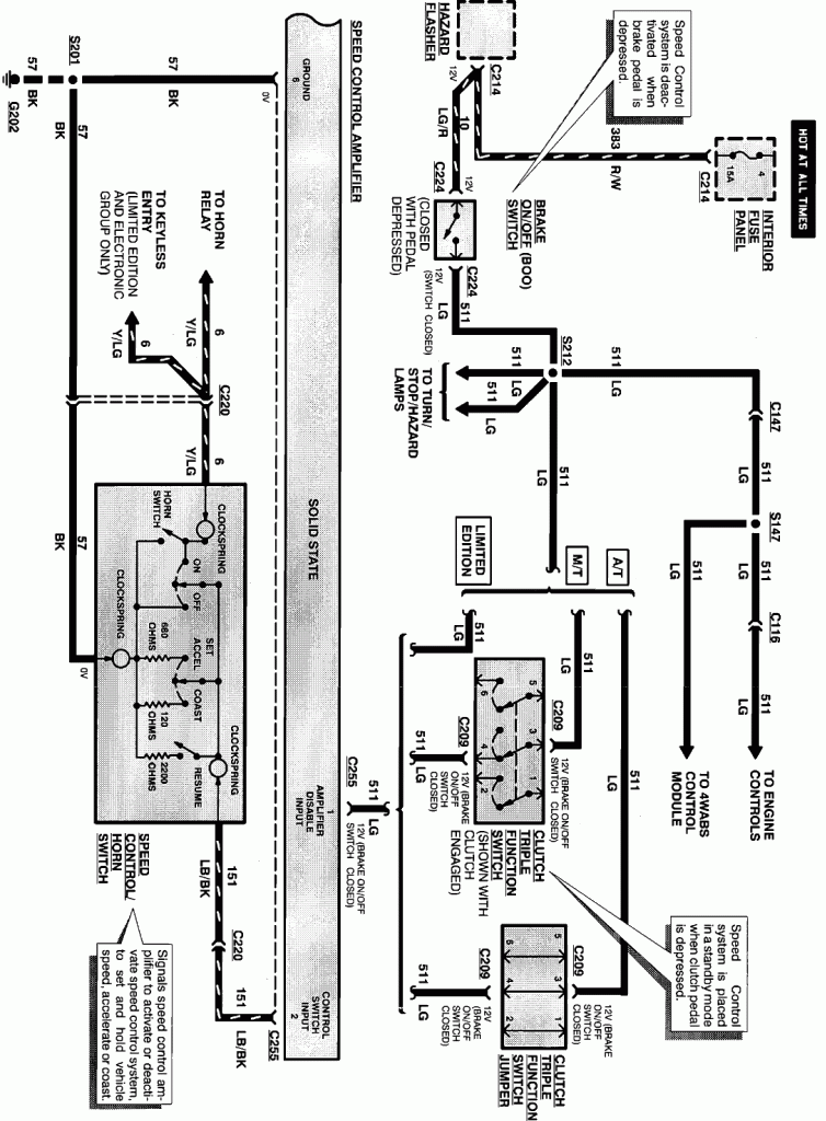

The reason is that the cruise is disengaged by brake light activation.
So if the PCM gets a signal that the brake has been applied = disengage. even if it's a bogus signal.

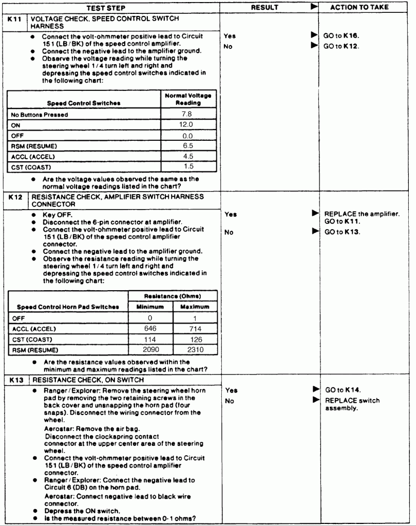

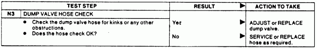

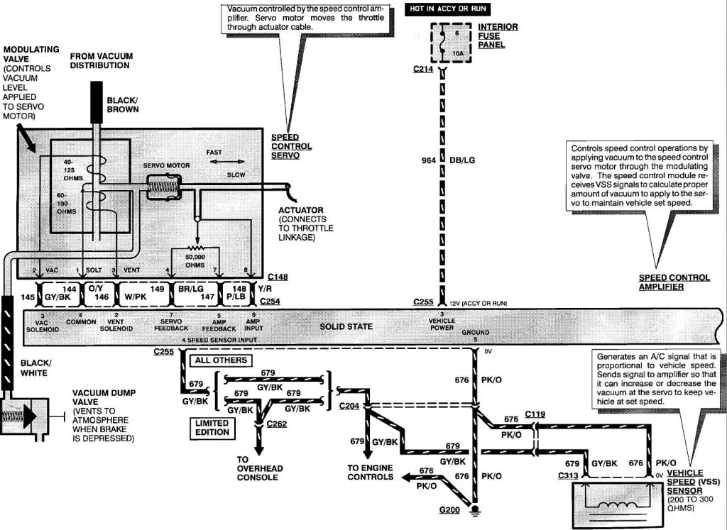

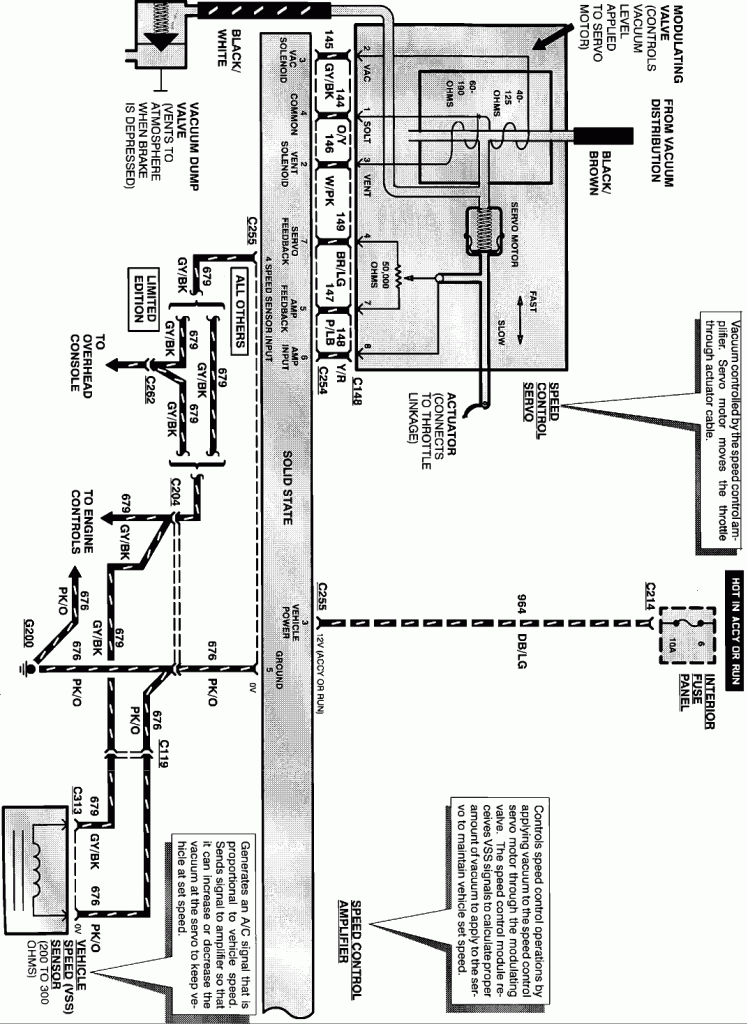

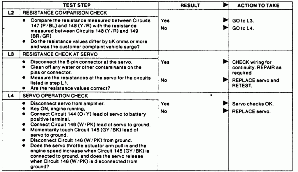

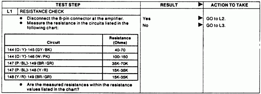

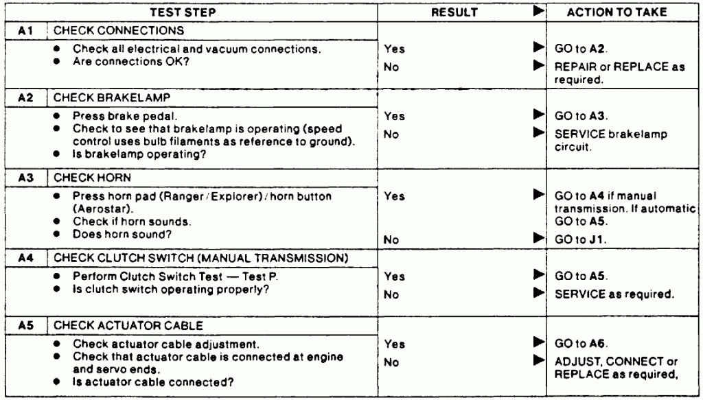

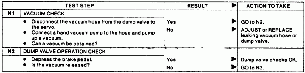

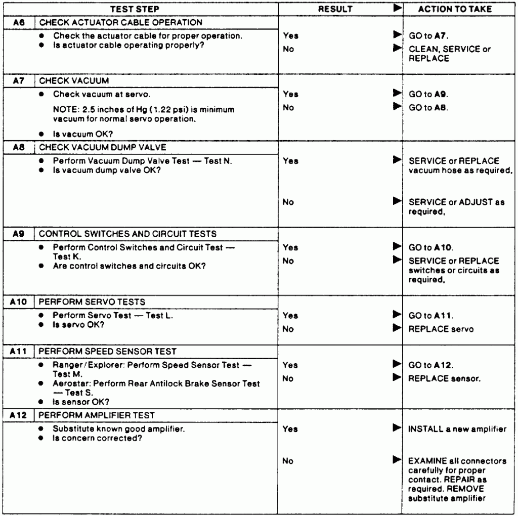

Here's Ford's entire trouble shoot for cruise in the first gens.
Pics are out of order but copy/paste print and you can make a booklet.
NOTES: Guide covers manual trans and automatic. i.e. auto trans will not have clutch dump.
NOTES: The dump valve is part of the speed control servo for auto trans. Or is near by connected by vacuum hose.
NOTES: Vehicle minimum speed for cruise is 40 mph. (in your case the VSS sounds wonky as well. I'd start there Test with multimeter 200-300 ohms as seen on last pic.
OH! ONE MORE NOTE ::VERY IMPORTANT.....STORED BRAKE FAULT CODES WILL PREVENT CRUISE ENGAGE! CLEAR THE COMPUTER AS YOU TROUBLE SHOOT. YOU WILL CAUSE FAULTS AS YOU GO.
