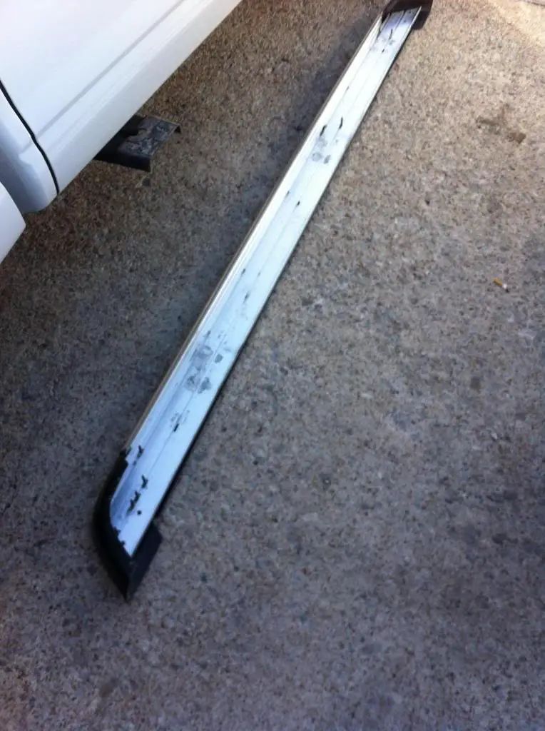

That being said, I am happy with the end result. I wanted to share some pictures here on how these things come apart. It seemed like the center plastic would pop out OK, but I didn't want to take the chance until I could see them better, under good lighting. You can easily just pull the centers off the boards and paint them. My corners needed painting also, so I wasn't too unhappy that I just removed everything.
Here is a shot of them apart:
You can see how they are clipped on:
They snap into the aluminum tracks. Also, I would suggest not bothering with cleaning items not seen, as they help aid in positioning the movable studs back to their original locations for re-installation. It can be a bear getting everything lined back up to drop in place. Depends on how well your neck and back move, I guess.
