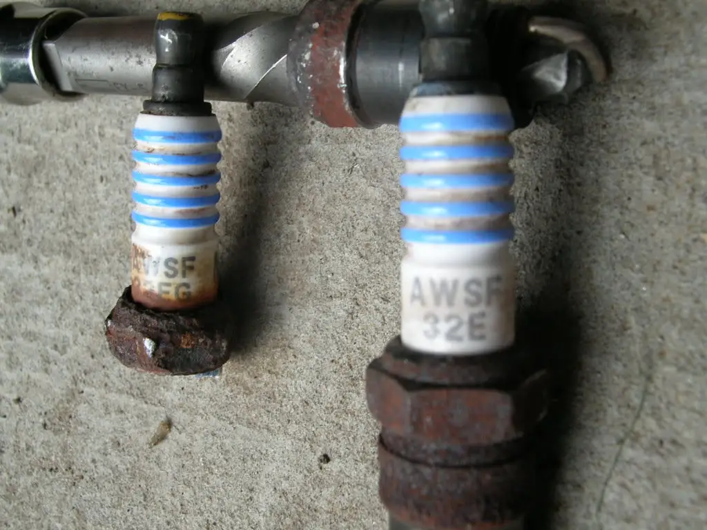

I hate to hi jack but is that the reason one side of my 5.0 had diff numbers on the plugs?

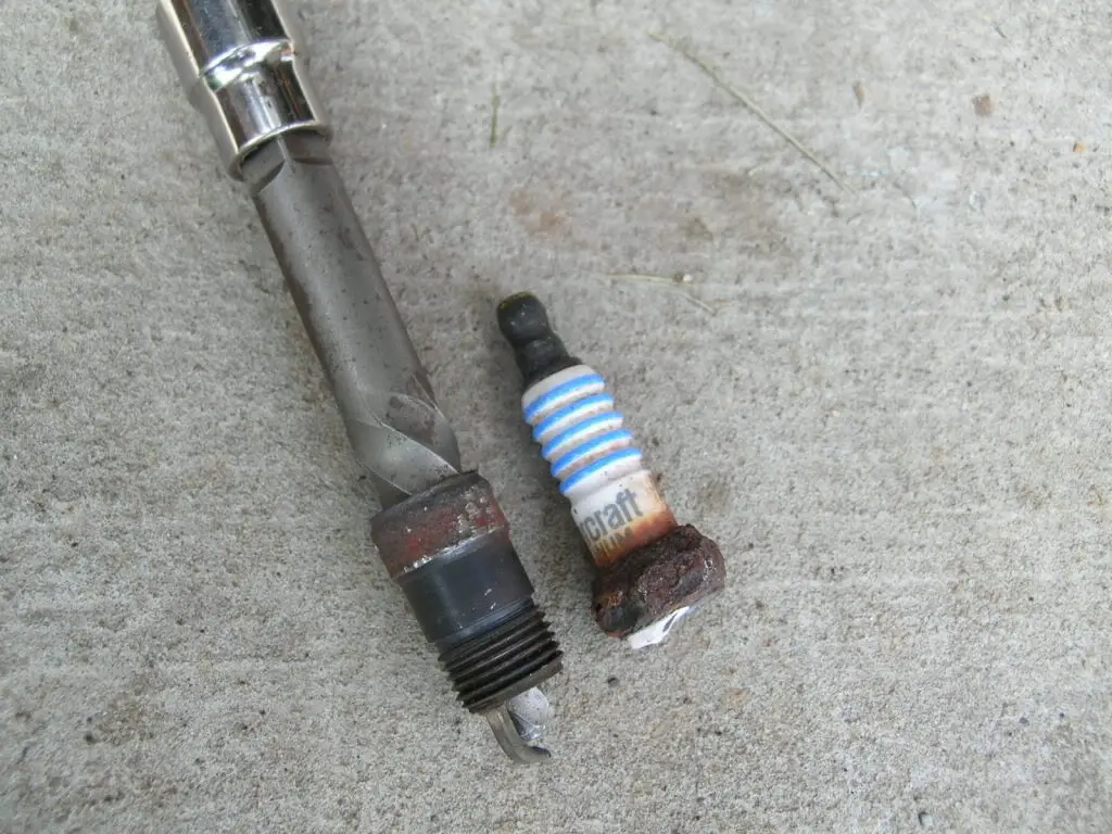

A few were a bish to get out..broke one,but got it out with a easy out!
97k on the car and i think the plugs..lol.
G for ground?
I think the G suffix identifies that the platinum is on the normally grounded outer electrode. I doubt that they were ever available anywhere except on the assembly line. For my own information, which bank had the G plugs (passenger or driver)?

The g plugs were on the passenger side.
Ok I found out the pass side fires from ground to center on the plug.
The g apparently stands for ground on that side.

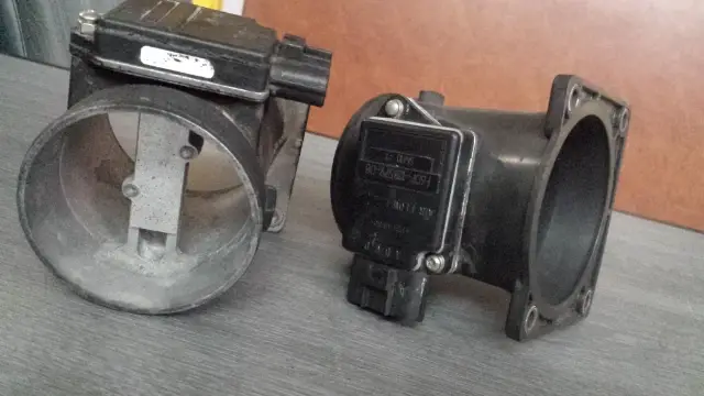

It could just be the angle of the picture messing with my vision, but the picture of the two Mass Airflow Housings (black plastic, grey aluminum) are of different sizes.
The MAF is tuned for a specific engine size and housing size. If I remember correctly the first gen guys are able to use larger maf housings due to not as much software in the pcm. 2nd gen's do not like larger housings and will run really rough and sputter at idle with the wrong sensor, or housing.... Trust me... I have a 2nd gen 4.0 and swapped the housing to a larger 5.0 housing and it ran like crap..
It might be worth a look to make sure your old MAF and housing are the same size and part numbers as your replacement
Same question
I had the same question but when I read thru the other "Registry" type thread the only documented engine related mod after the engine swap was about the aftermarket headers. Also, if a larger than stock diameter MAF sensor was installed the engine would run lean instead of rich. The larger diameter would decrease the measured air mass flow and the PCM would decrease the injector pulse width accordingly.
oh! yeah its just the angle of the camera, the size are same except the plastic and the original is alloy...
I got this from the wrecking yard and hey supplied me the plastic, but i noticed the last three letters (part numbers) were different from the original. then I rang and they says this Air Flow Meter came from Ford Taurus...
would that make a difference..?
