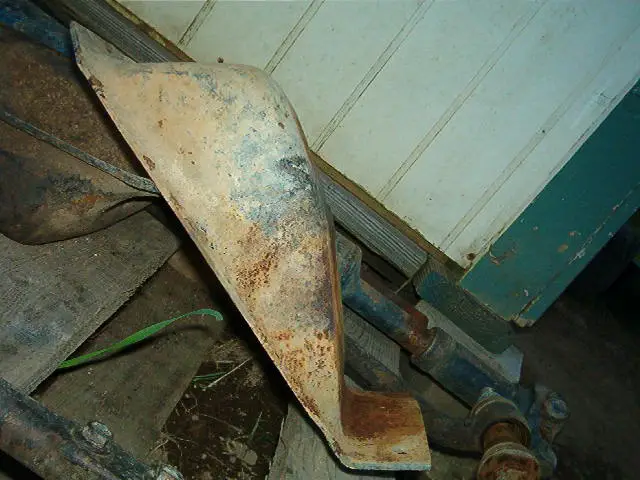

When I got my 78 f-150 for my SAS it came with dual shocks and the front shock mount was also part of the trac bar mount, if you look in my d44/9" swap thread I think I have pictures of it in there.
Also the coil buckets from the same truck have the springs sitting about 1 1/2" away from the frame instead of up next to it like the EB type.
